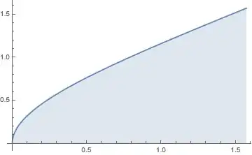

Here is a graph of the function, and shaded value of the integral, which suggests there isn't a major error:
    Mathematica is renown for not dealing optimally with polylogarithms or high-order hypergeometric functions, so the fact that Mathematica is not able to simply the shown output does not really imply anything significative. – Jack D'Aurizio Aug 09 '18 at 00:21
