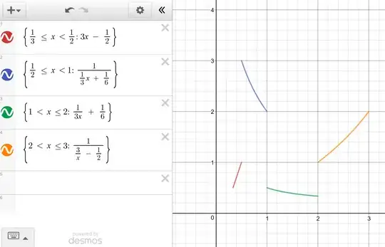

Piecewise examples are possible. For example, we can define $f: [\frac13,3] \to [\frac13,3]$ as follows: $f(1) = 1$, and for all $\frac13 \le x < \frac12$, \begin{align*} f(x) &= 3x - \frac12 &&\in [\tfrac12, 1)\\ f(f(x)) &= \frac1x &&\in(2,3] \\ f(f(f(x))) &= \frac1{3x - \frac12} &&\in(1,2] \\ f(f(f(f(x)) &= x &&\in[\tfrac13,\tfrac12) \end{align*}
Here is a plot: plot
The idea is that we send $[\frac13,\frac12)$ to $[\frac12,1)$ in an increasing manner, then send $[\frac12,1)$ to $(2,3]$, then send $(2,3]$ to $(1,2]$, and finally send $(1,2]$ back to $[\frac13,\frac12)$. It's a 4-cycle.
I'm not sure this example is any less artificial, but it's piecewise continuous (I think being continuous outright is impossible). The example is derived from the following more general necessary and sufficient condition:
Proposition. Assume that $f$'s domain is some set $A \subseteq \mathbb{R}$ which is closed under multiplicative inverse and does not contain $0$. A necessary and sufficient condition for $f$ to satisfy this equation is then that $f(1) = 1$, and that the remaining elements of $A$ are partitioned into quadruples $$ \left\{ a, \frac1a, b, \frac1b \right\}, $$ where $a, b < 1$, $a \ne b$, and $f$ behaves on this set as follows: $f(a) = b$, $f(b) = \frac1a$, $f(\frac1a) = \frac1b$, and $f(\frac1b) = a$.
As a consequence of this, $f(f(f(f(x)))) = x$ for all $x$.
Proof: consider where $f$ maps a pair of elements $\{x, \frac1x\}$, for any $x \ne 1$. Letting $y = f(x)$, we consider the pair $\{y, \frac1y\}$, and notice that $f$ maps $\frac1y$ back to $x$ by the equation $f(1/f(x)) = x$. But then plugging in $\frac1y$ to the equation instead gives that $f$ maps $\frac1x$ to $\frac1y$. Finally, plugging in $\frac1x$ to the equation instead we get that $f$ maps $y$ to $\frac1x$. So $f$ sends $x \mapsto y \mapsto \frac1x \mapsto \frac1y \mapsto x$.
If $x = 1$ or $y = 1$ then this all collapses to $f(1) = 1$. Otherwise, $x, y$ must be distinct, and we get the claim by setting $a$ to be whichever of $x, y, \frac1x, \frac1y$ is smaller than $1$ and maps to something smaller than $1$, and $b$ to whichever of $x, y, \frac1x, \frac1y$ is smaller than $1$ and maps to something larger than $1$.
