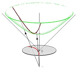

Embedding in Minkowski space
Now comes the tricky part : I will give you a third model of the hyperbolic plane $\mathbb{H}$, this time as a subvariety of a Minkowski space $\mathbb{R}^{1,2}$ with metric of signature $(-,+,+)$. More precisely, consider the upper sheet of a hyperboloid in $\mathbb{R}^{1,2}$. The metric on this space is $g_{\mathbb{R}^{1,2}} = -\mathrm{d} X_0^2 + \mathrm{d} X_1^2 + \mathrm{d} X_2^2$, and the hyperboloid sheet is defined by the equation $$X_0^2 - X_1^2 - X_2^2 = 1 \, , \qquad X_0>0 \, . $$ We can parametrize this by two angles $\alpha$ and $\beta$: \begin{eqnarray*} X_0 &=& \cosh \alpha \\ X_1 &=& \sinh \alpha \cos \beta \\ X_2 &=& \sinh \alpha \sin \beta \end{eqnarray*} Using these coordinates, we find that the metric on the sheet is $$ g_{\mathbb{H}} = \mathrm{d} \alpha ^2 + (\sinh \alpha)^2 \mathrm{d} \beta^2 \, , $$ and again we can compute the Ricci scalar and find $R=-2$. The relation between this model and the Poincaré disk model is given by a stereographic projection. More precisely, the Poincaré disk is the stereographic projection of the hyperboloid sheet on the plane $X_0=0$ with respect to the point $(X_0,X_1,X_2)=(-1,0,0)$. (image from Wikipedia).
Let us work out the details: a point $(X_0,X_1,X_2)$ on the hyperboloid sheet is mapped by this projection to the point $$ \left( 0 , \frac{X_1}{1+X_0} , \frac{X_2}{1+X_0} \right) \, . $$ Using that, we obtain the relation between the coordinate on the disk $u$ and the coordinates $\alpha$ and $\beta$ on the hyperboloid, $$u = \frac{\sinh \alpha}{1+\cosh \alpha} e^{i \beta} \, . $$ You can check that the two expressions for $g_{\mathbb{H}}$ given above are indeed the same.
