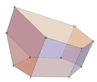

They are apparently a building block for living creatures. One simple set of vertices that look reasonable with planar faces is {{2,4,0},{0,4,2},{0,2,4},{2,0,4},{4,0,2},{4,2,0},{1,3,6},{3,1,6},{6,6,2},{4,16,14}/3,{16,4,14}/3,{5,5,0}}.

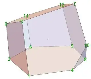

Using code at Canonical Polyhedra, a canonical form looks like
canonical scutoid
