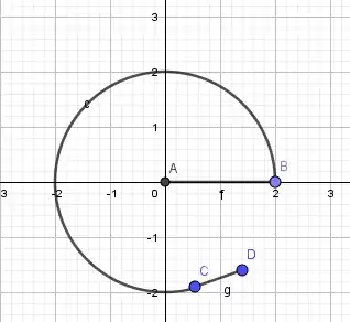

I can find an approximation which convinces me that one could find (numerically) one that satisfies your conditions. My first cut at a "spiral" is drawn below. It consists of the line segment from the origin to $(2,0)$, an arc of a circle from $(2,0)$ to $(2 \cos \theta, 2\sin \theta)$ and a line segment tangent to the circle of length $L$. I find that for $\theta = 4.95, L\approx 0.786$ the $y$ centroid is correct and the $x$ centroid is very slightly right of center. Shortening the initial segment can move the $x$ centroid back without impacting $y$.
I realize my straight line and circle do not meet the monotonic increase of $r$ with $\theta$ but they were easy to calculate and we can approach them arbitrarily closely.
