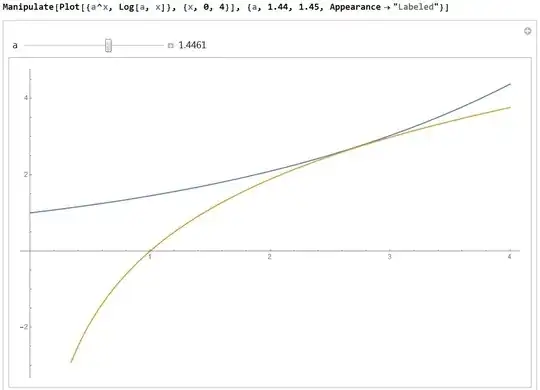

Such $a$ likely exists and is somewhere in the following range which can be narrowed down further: $$1.44\lt a \lt 1.45$$
EDIT: $$a\approx1.444667861, \qquad x\approx 2.71827$$
Note that $x$ value is very close to $e$. I don't know how to explain it but it makes this problem really, really interesting!
