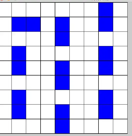

edit : For 9 * 9 grid this is the best solution :9*9 grid

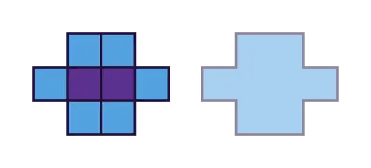

Instead of thinking about the squares of the grid, think of the edges between adjacent squares, of which there are $2×8×7=112$. Now look at a domino:
A domino and its zone
On the left, the domino itself is in a deep blue. A new domino makes edge-to-edge contact or overlaps the original domino iff the new domino overlaps a light blue square iff the edge between the new domino's two squares coincides with any of the short purple line segments. This set of at most 23 edges I will refer to as the original domino's zone (if close to the board's edge, some segments may lie off the board or fall on the board's boundary; we do not consider such edges).
The problem of placing dominos to mandate edge-to-edge contacts – a dominating covering – now becomes a problem of covering all 112 edges by domino zones. If an edge does not lie in any zone, it can serve as the middle edge of a new domino, with no edge contact.

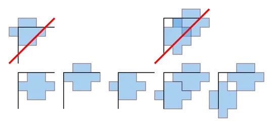

Now consider the configurations of zones that can cover the two edges incident to a corner square. There are five distinct viable configurations up to reflection, which I will call type 1 to type 5 from left to right:
Corner configurations
The two crossed-out configurations are not viable, because they can be replaced by the configurations immediately below them without uncovering any covered edges. Any dominating covering needs four of these configurations, one for each corner.
We can quite easily show that we can only use at most one instance of the type 4 and type 5 configurations combined. None of the configurations covers the following edges:
Must-be-uncovered edges
Furthermore, at least two zones are required to cover these edges, which means that the corner configurations can use at most five zones.

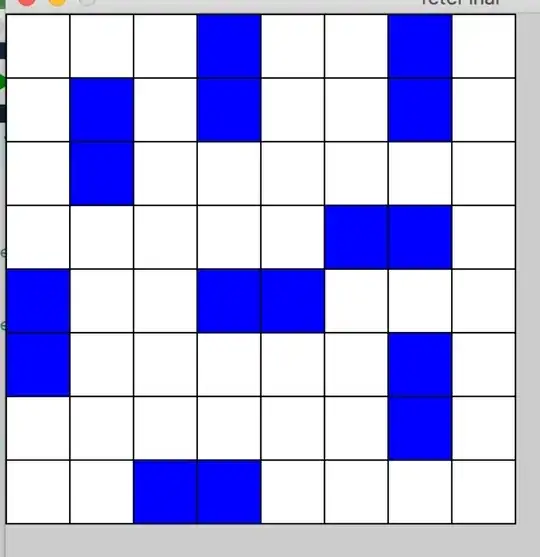

However, there do exist near-dominating coverings that cover 111 of 112 edges (leaving exactly one place for a new domino without making edge contact). Here is one:

    Parcly-- In the placement of OP diagram, there are 11 squares not in zones. So in that sense goal not to place dominoes so zones cover all 64 squares. Some covered squares (3 I think) in OP diagram are shared by 2 zones... and with 7 dominoes whose zones cover the max of 56 squares, there may be say 8 squares not in zones; this doesn't seem immediately impossible given OP diagram where 11 are not in zones. As you can see I may be confused about your argument. – coffeemath Jul 19 '18 at 08:14
  • @ParclyTaxel I agree with the above comment now. For a 9 by 9 grid I have a solution of 9. 8 * 9 is 72 which is less then 9 * 9 = 81, yet this grid still works. – Rumi Jul 19 '18 at 08:27
