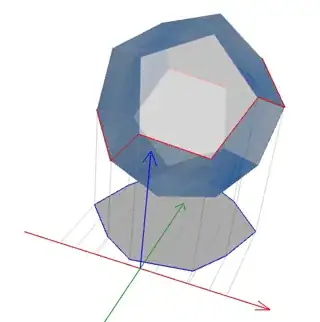

Let $E(P)$ be the edges of $P$ and $E'(P) = \{ e \in E(P) : \pi_2 e \subset \partial \pi_2 P \}$. When none of the faces of $P$ is tangent to the $z$-direction, edges in $E'(P)$ will get mapped to edges of $\pi_2 P$. Furthermore, the correspondence will be bijective. In the illustration below, $P$ is a dodecahedron and $\pi_2 P$ is the gray polygon on $xy$-plane. $E'(P)$ are those red edges on $P$ and under $\pi_2$, they get mapped to the blue edges of $\pi_2 P$.
$\hspace1in$ Projection of Dodecahedron to xy-plane and x-axis
If one further project these edges down to $x$-axis using $\pi_1$ and sum over their length, one will notice the sum overs those edges in $E'(P)$ whose $\pi_2 e$ is facing upwards or exactly right equals to the caliper diameter of $P$ along $x$-direction. The same thing happens to the sum over those edges whose $\pi_2 e$ is facing downwards or exactly left. This leads to
