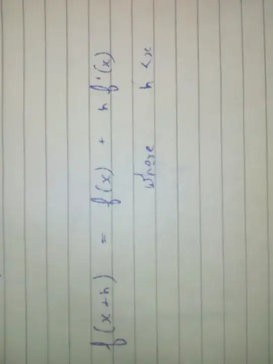

    Although Taylor series (this is, finding the polynomial of degree $\leq n$ that best approximates $\sin$) would work, and perhaps there are other series that converge faster to the function, a quick google search yields the following algorithm: https://en.wikipedia.org/wiki/CORDIC – user347489 Jul 16 '18 at 10:58
    My bad, I was assuming you took a calculus 1 class. the idea is that some functions can be represented (at least around a certain point) by an infinite sum. That's called a taylor series. you can also approximate the value instead of calculating it completely by taking the first terms of the infinite sum. Check this list out, for some well-known taylor series: https://en.wikipedia.org/wiki/Taylor_series#List_of_Maclaurin_series_of_some_common_functions – GuySa Jul 16 '18 at 11:00
  • Ok, I tried to calculate $90-90^3/6$, and $90/180\pi-(90/180\pi)^3/6$ but I didn't get 0. Why? – bcubeu26dncs Jul 16 '18 at 11:20
    well I kind of lied to you, the formula I gave you is only an approximation and is close to sine only for values close to 0. you can see in the plot here that it is very close to sine but they grow apart as you go further away from 0. I recommend you the identities you know about sine to get to a number close to 0 and then use the formula – GuySa Jul 16 '18 at 11:26
  • Now, i got a complete picture of how to calculate it. Thank You – bcubeu26dncs Jul 16 '18 at 11:31

Well you can use the taylor series or you can use an approximation which I am suggesting, but it will be only useful if you know the value of sin of some nearby anglesh is very less than x
  • Worth elaborating. Use various well known values, plus identities to get values for an angle as near as possible. Then an approximation apporach such as Taylor can converge rapidly and be practical. – Keith Jul 16 '18 at 21:44
