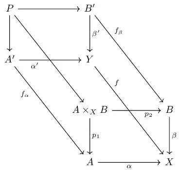

Show that the pullback along an arrow $f:Y\to X$ of a pullback square over $X$, $\require{AMScd}$ \begin{CD} A\times_X B @>>> B\\ @VVV @VVV\\ A @>>> X \end{CD} is again a pullback square over $Y$.
So I started by doing the obvious thing and I drew a cube with the goal of eventually applying the two-pullbacks lemma.
(Original image here.)
The goal is to show that the back fact of the cube is a pullback square. The triples $(A', \alpha', f_\alpha)$ and $(B', \beta', f_\beta)$ are obtained as pullbacks of the diagrams $\require{AMScd}$ \begin{CD} A\\ @V\alpha VV\\ X @<f<< Y \end{CD} and $\require{AMScd}$ \begin{CD} B\\ @V\beta VV\\ X @<f<< Y \end{CD} This much seems pretty clearly the right way to do things, but then I run into a problem. There are two ways to induce each of the three arrows $P\to A'$, $P\to B'$, and $P\to A\times_X B$ as pullbacks. My thinking is that I probably don't want to induce $P\to A'$ or $P\to B'$ as the pullback of $\alpha'$ and $\beta',$ so I induce those maps as pullbacks $\require{AMScd}$ \begin{CD} P @>>> A\times_X B\\ @VVV @VV p_1 V\\ A' @>>f_\alpha > A \end{CD} and $\require{AMScd}$ \begin{CD} P @>>> A\times_X B\\ @VVV @VV p_2 V\\ B' @>>f_\beta > B \end{CD} The problem is that this induces two different maps $g_1:P\to A\times_X B$ and $g_2:P\to A\times_X B$. If I could show that these maps are the same, then I could apply two-pullbacks twice and be done. However, I have no idea how to do this. It seems that it should come from the uniqueness of maps to pullbacks, so I would try and show that $p_1g_1=p_1g_2$ and $p_2g_1=p_2g_2$. Uniqueness would then give $g_1=g_2$. Alas, I don't see why this would be true. Perhaps I need to pullback $\alpha'$ and $\beta'$ and show that those maps are the the same as the ones I have already induced. Any hint would be appreciated.

    By the way : in your last two diagrams, shouldn't $\alpha'$ (resp. $\beta'$) be $f_\alpha$ (resp. $f_\beta$)? Note also that with your approach, you actually have a more serious problem than determining whether the two maps $P\to A\times_X B$ are equal : a priori, you can't even be sure that the two pullbacks considered are equal. – Arnaud D. Jun 23 '18 at 19:48
  • @Arnaud D. Yes. I'll fix that right away. – D. Brogan Jun 23 '18 at 19:49
  • @Arnaud D. That's also a good point. – D. Brogan Jun 23 '18 at 20:06
For anyone who cares, I have figured out the answer to the problem. If one labels the map $\alpha\circ p_1=\beta\circ p_2:A\times_X B\to X$ as $h$, then we have two commutative triangles making up the front face of the cube. Take the triangle $A\times_X B\to A\to X$. One forms pullbacks $h'$ and $\alpha'$ of $h$ and $\alpha$ respectively along $f$, and then two-pullbacks gives a map $q_1:P\to A'$ such that $\alpha'\circ q_1=h'$ and such that left side of the cube is a pullback. Do the same for the other triangle on the front face. Then one evidently gets commutativity of the entire cube, and every face save for the back face (the one we care about) is a pullback square. Now, by two-pullbacks, if we show that the rectangle formed by the back and bottom faces is a pullback, then since the bottom face is a pullback, the back face must be as well. But since the diagram commutes, this rectangle is the same as the rectangle formed by the top and front faces. Since these faces are each pullback squares, the rectangle is as well, and two-pullbacks gives that the back face is indeed a pullback.
