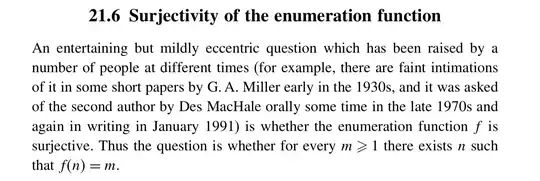

That is not known (as far as I am aware). There is some relevant discussion in the book by Blackburn, Neumann, and Vekataraman "Enumeration of finite groups". The relevant section is $21.6$ "Surjectivity of the enumeration function" on page $238$.
While I have not read through that section, my understanding is that the authors do not provide a definite answer there. (Though they point out that this question has been asked before, several times; see below.) My suspicion is confirmed by the fact that it is repeated as an open problem on page $268$ (Question $22.36$).
