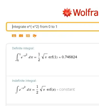

Integrating term by term is probably the easiest, as the powers of $0$ and $1$ are easy to compute. It is guaranteed to work because the series is absolutely convergent. The alternating series theorem then says the error is less than the first neglected term and of the same sign so once a term is less than $0.001$ you are done. You can get an exact answer in terms of the error function and then look up the z-score table to get a figure to compare to. The answer from Alpha
