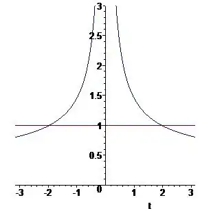

The iteration $x \to f(x) = \log_b(x)$ (using the principal branch of log) has a fixed point at $x = x^*$ where $x^* = -W(-\ln(b))/\ln(b)$, $W$ being the Lambert W function. The fixed point is stable if $|f'(x^*)| < 1$ and unstable if $|f'(x^*)| > 1$, where $f'(x^*) = \dfrac{-1}{W(-\ln(b))}$. For $b = e^{it}$, $-\pi < t < \pi$, the plot of $|f'(x^*)|$ looks like this:
The transition between stable and unstable occurs at approximately $t = t_0 = \pm 1.96130884645945594019766830511$.
I doubt that this has a closed form.
EDIT: That is for the "0" branch of LambertW. The other branches also produce fixed points, some of which will be stable. Which fixed point or cycle a particular initial point will go to might not be easy to predict.

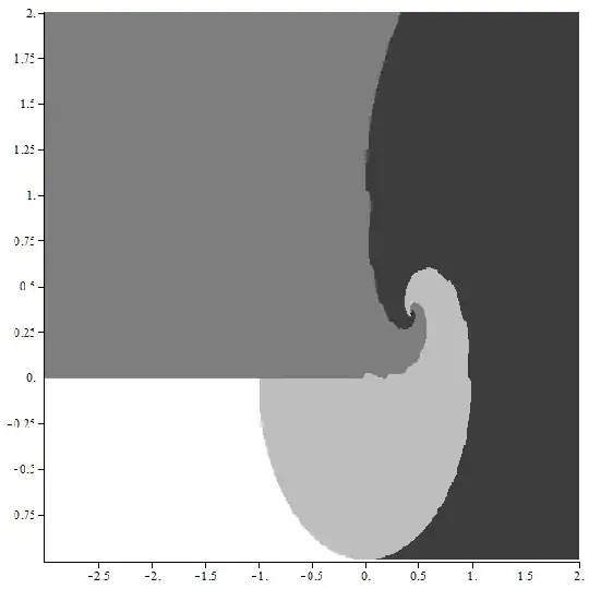

EDIT: For $b=i$, there is an attracting $3$-cycle $[-1.14012370875626+.706579007931335 i, 1.646798829-.1869454749 i, -0.07196134893-.3216429665 i]$, and there is an attracting fixed point $-1.861743075-.4107999686 i$ (from the "$1$" branch of Lambert W). These both have big basins of attraction, as shown in the plot below. Points in the white region are attracted to the fixed point, those in gray or black are attracted to the $3$-cycle.
EDIT: Not all branches of Lambert W produce fixed points: you do need $\text{Im}(x^* \ln(b)) \in (-\pi,\pi]$. At $b = (1+i)/\sqrt{2}$ the three-cycle seems to have disappeared, and nearly everything is attracted to the stable fixed point from $i=1$.
EDIT: It seems that the three-cycle disappears at approximately $b = e^{1.083876408 i}$ as one of its points hits the negative real axis.
