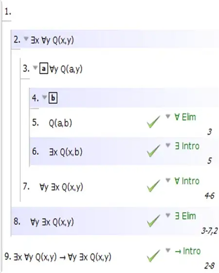

4) is indeed true. Your reasoning is also correct ... though a bit complicated I find. Why not: If there is something (and let's call that something 'Bob') that stands in relation $Q$ to everything, then if I pick anything, can I find something that stands in relation $Q$ to it? Of course ! Bob!

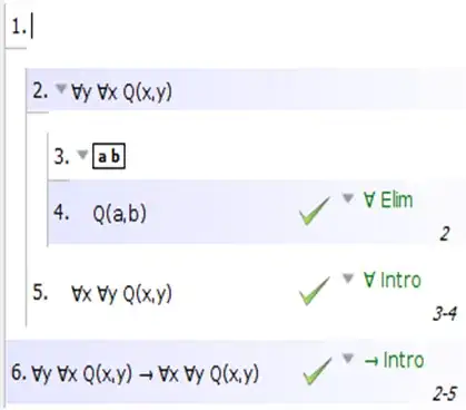

5) is true! If everything stands in relation $Q$ to everything, then everything stands in relation $Q$ to everything
Here are formal proofs for 4) and 5) created in Fitch, a Fitch-style proof system:

  • regarding the claims that are true: i should show that they are true either by a series proof like i tried to do or another way. is there another way to give a prove that is not complicated? (especially for 4,5) – BeginningMath Jun 02 '18 at 17:21
  • could you please help me with showing a formal way to prove 4,5? i think i can handle the rest, but with 4,5 i am quite lost, even though it's logical to me – BeginningMath Jun 02 '18 at 18:43

    @BeginningMath: If you're interested in a purely formal proof, you can find a sample for a generalized version of (4) in a Fitch-style system here under "Example". In general, Fitch-style systems are the ones that can be actually used in mathematical reasoning, whereas what you typically find in a logic textbook is a Hilbert-style system, which is almost useless to use in reasoning but is extremely easy to study. My suggestion is to understand Fitch-style deduction, as via that understanding it is easy to understand all other deductive systems. – user21820 Jun 03 '18 at 16:30
  • @user21820 Nice! You should link that page more often! – Bram28 Jun 03 '18 at 16:40
    Thank you! And I also like your included Fitch-style proofs. Is the software you used freely available? @BeginningMath: Just a note, Bram28's system is practically the same as mine except that his introduces an extra subcontext at (3) that represents "Let $a$ be such that $\forall y ( Q(a,y) )$.", and later uses the $\exists$-elim rule on "$\exists x \forall y ( Q(x,y) )$" (2) and "$\boxed{a} \forall y ( Q(a,y) ) \vdash \forall y \exists x ( Q(x,y) )$" (3−7) to get "$\forall y \exists x ( Q(x,y) )$" because (7) does not involve $a$. – user21820 Jun 04 '18 at 03:57
    In English, (2) says "some $x$ satisfies $G$" and (3−7) says "given an $a$ that satisfies $G$, we can conclude $C$" and since this $C$ does not depend on the choice of $a$, we know that (2) must imply $C$. – user21820 Jun 04 '18 at 03:57
