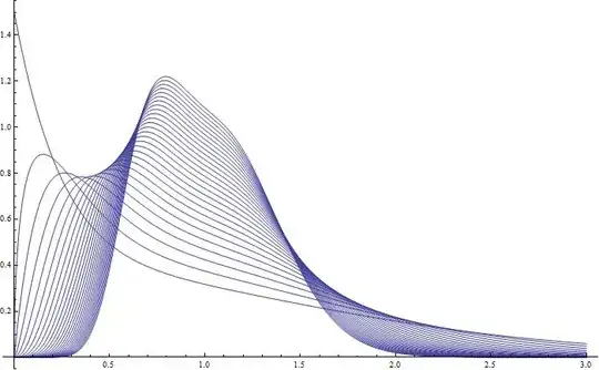

Here: \begin{eqnarray} a_m^{(p)} := \left\{ \begin{array}{rr} 3 & \mbox{if $m=1$}\\ \frac{1}{4}(-13+23 p) & \mbox{if $m=2$}\\ \frac{1}{10}(-8+7p)(-5+13 p) & \mbox{if $m=3$}\\ \frac{1}{336} (p (p (4353 p-12386)+8811)-1666) & \mbox{if $m=4$}\\ \frac{1}{336} (p (p (p (5797 p-26118)+33443)-14274)+2016) & \mbox{if $m=5$}\\ \vdots \end{array} \right. \end{eqnarray} Below we plot the spectral density for $T=3,\cdots,30$.

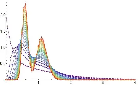

Below I plot the spectral densities for $T=3,5,7,\cdots,103$ (Violet, Blue all the way through to Red). We have: enter image description here
Here $(\lambda_1,\lambda_2)=(0.60735,1.10567)$ .
