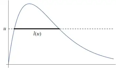

Indeed, this follows from $\int_{0}^{\infty} \frac{x-1}{e^x + ax} \, dx = 0$ using OP's computation. Since the graph of $x \mapsto xe^{-x}$ is unimodal, for each $u$ in the range we may define the 'width' $l(u)$ of the graph of $xe^{-x}$ at height $u$.
$\hspace{8em}$ Graph
To be precise, we define $l(u)$ as the Lebesgue measure of the set $\{ x > 0 : xe^{-x} > u \}$. Then
$$ I(a) = \int_{0}^{\infty} \left( \int_{xe^{-x}}^{\infty} \frac{du}{(1+au)^2} \right) \, dx \stackrel{\text{(Fubini)}}{=} \int_{0}^{\infty} \frac{l(u)}{(1+au)^2} \, du. $$
Now $l$ can be written explicitly in terms of the Lambert W-function:
$$ l(u) = \begin{cases} W(-u) - W_{-1}(-u), & \text{if } u \leq \frac{1}{e} \\ 0, & \text{if } u > \frac{1}{e} \end{cases} $$
So it follows that
$$ I(a) = \int_{0}^{\frac{1}{e}} \frac{l(u)}{(1+au)^2} \, du = \int_{0}^{\frac{1}{e}} \frac{W(-u) - W_{-1}(-u)}{(1+au)^2} \, du. \tag{1} $$
This suggests that the asymptotic behavior of $I(a)$ as $a\to\infty$ is intimately related to the asymptotic behavior of $W_{-1}(u)$ as $u\to 0$. For instance, using the fact that
$$ l(u) = -W_{-1}(-u) + \mathcal{O}(1) = -\log u + \log\log(1/u) + \mathcal{O}(1) $$
on $(0, 1/e]$ as $u\to0$, we obtain
$$ I(a) = \frac{\log a}{a} + \frac{\log\log a}{a} + \mathcal{O}\left(\frac{1}{a}\right) \quad \text{as } a \to \infty. \tag{2} $$
