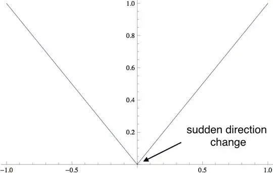

This could be clarified by using a physical interpretation for integration. In particular, if you integrate velocity, you get displacement. A discontinuity of the integrand would then by a point at which the velocity suddenly changes - which would lead to a kink in the object's path.
For instance, suppose you have a function $$f(x)=\begin{cases} -1 &\text{if }x\leq 0 \\ 1 & \text{if }x> 0 \end{cases}$$ If you integrate this, you get a function $F(x)=|x|+C$. You can check this by direct computation. This has a kink at $x=0$, which is exactly where the integrand switches from negative to positive. That is, if you image this as the position of an object, before $x=0$, the object is moving downwards at a constant rate, and after $x=0$, it is moving upwards, which causes the position to not be differentiable at $x=0$.
This is all fairly evident from a graph of $|x|$. Note that its derivative is $-1$ for all negative values and $1$ for all positive values and a change in the direction occurs where the discontinuity in the integrand was.
In response to the edit to your question: This argument does not apply to removable discontinuities like the $$f(x)=\begin{cases}1 & \text{if }x\neq 0 \\ 5 &\text{if }x=0\end{cases}$$ function you give. It is only a property of jump discontinuities. Your integration of the function is correct. For physical interpretation, it is completely inconsequential if an object tries to move with a velocity of $5$ for absolutely zero time - there needs to be some interval (or, more precisely, a set of positive measure) on which the integral has change in order to reflect any change in the result. From the mathematical side, if you've defined integration by Riemann sums, note that the contribution to the integral of the one place where $f$ takes the value $5$ becomes decreasingly large as you use finer and finer partitions, thus does not matter at all to the integral.
