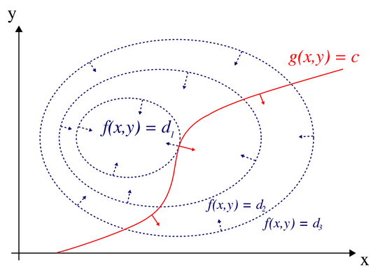

I noticed that all attempts of showcasing the intuition behind Lagrange's multipliers basically resort to the following example (taken from Wikipedia): enter image description here
The reason why such examples make sense is that the level curves of the f function are either only decreasing (d1 < d2 < d3) or only increasing (d1 > d2 > d3) concentrically, so it's obvious that the most centric level curve touching the constraint curve is the minimum/maximum that we are looking for.

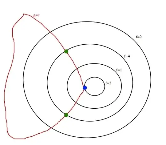

But in real life examples, I imagine we can have a function f whose level curves might look like this (they don't decrease/increase in an orderly fashion):
In the above example that I thought of, the maximization of f (subject to the g constraint) would not be the blue point (where the constraint curve is tangent to a level curve of f), but the two green points.
I haven't seen this kind of level arrangement in any tutorial/lecture/course and it just seems to me that every demonstration conveniently picks the most favorable scenario for presenting the intuition. I must be wrong somewhere but I can't figure out where.

I am imagining your proposed $f(x, y)$ to look like ripples on a pond, with the $f=4$ contour being a wave crest ring, and the $f=1$ contour being a wave trough ring.
The green points are unconditional local maxima for $f$. That is, they are optima even if we don't enforce $g=c$. At those points, the gradient of $f$ is the zero vector. The equation $\nabla f = \lambda \nabla g$ will still hold for $\lambda = 0 $, so your example hasn't broken anything. All that happens is that we lose the geometric statement "gradients are parallel" because the zero vector has no direction. This always occurs when an unconditional optima of $f$ happens to perfectly touch $g$.
The $f=3$ contour is more interesting, because I have not imagined it to necessarily be a crest or trough. It could just be part of a swell. Regardless, the blue point has to be listed as a candidate in the Lagrange multiplier method. The method says that all constrained optima will satisfy $\nabla f = \lambda \nabla g$ but it doesn't say that non-optima can't. It is just a necessary condition.

If $f$ is continuous, this kind of arrangement can't happen. To see this, consider a continuous path going from the the $f=1$ curve to the $f=4$ curve. Let $(x(t), y(t))$ denote a (continuous) paramaterization of such a path with, say $(x(0), y(0))$ a point on the $f=1$ curve and $(x(1), y(1))$ a point on the $f=4$ curve.
Then we get a single variable continuous function by mapping $t$ to $f(x(t),y(t))$. If we plug in $t=0$, we get $f(x(0), y(0)) = 1$ and likewise, if we plug in $t=1$, we get $f(x(1), y(1)) = 4$. By the intermediate value theorem, there is some $t$ we can plug in for which $f(x(t),y(t)) = 3$.
In terms of your picture, what this says is that any continuous curve which starts at the $f=1$ curve and ends at the $f=4$ curve must pass through the $f=3$ curve. If you think about this, you should be able to convince yourself that this forces the curves $f=1$, $f=3$, and $f=4$ to be concentric, as it is in the pictures you typically see.
Edit: Let me try to address it a little differently so that you can see why the connectedness of the $f=3$ curve is irrelevant. The issue is that no one is claiming that a place where $f$ and $g$ are tangent is a max or min of $f$. Rather, the claim is the the only hope of finding a max or min of $f$ is at a point where $f$ and $g$ are tangent (for reasonbly smooth $f$ and $g$), or where $f$ already has a max or min.

  • If $f$ is discontinuous, I know of no general methods of maximizing it subject to a constraint. Even worse, generally there should be no reason that a maximum even exists for a discontinuous $f$. But perhaps for certain kinds of discontinuities, something is known. – Jason DeVito - on hiatus Apr 16 '18 at 22:07
    I understand from your reasoning why there must also be a level curve of f=3 between the f=1 and f=4 curves, but why can't there be two f=3 level curves? If, for example, the graph of f would look like a ripple effect on a water surface, then multiple concentric level curves of the same value would be possible, right? – Catalin Florea Apr 16 '18 at 22:30
    Yes, that can definitely happen. For example, $f(x,y) = \sin( \sqrt{x^2 + y^2})$ looks like that - there are infinitely many connected level curves corresponding to $f = 1$. – Jason DeVito - on hiatus Apr 17 '18 at 01:29
    I've tried to address your concern about $f=3$ having multiple components. Let me know if I can further clarify! – Jason DeVito - on hiatus Apr 17 '18 at 01:54
  • Thank you for your step-by-step explanation, it helped clear up my confusion! – Catalin Florea Apr 17 '18 at 18:38
