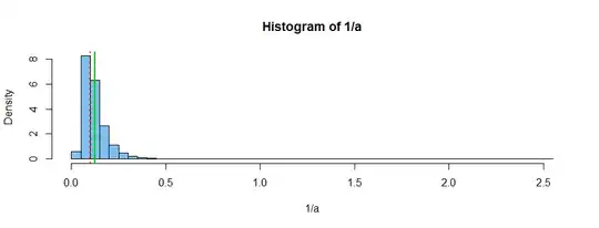

Here is a histogram of a million simulated values of $1/\bar X.$ The vertical dotted red line is at $\lambda = 0.1,$ but the mean of the histogram is near $0.125$ (vertical solid green line), pulled to the right by the long tail.
