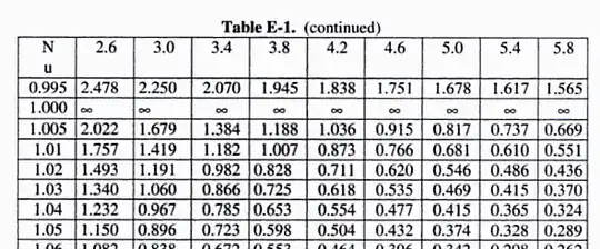

I implemented the Cauchy principle value method in python 2.7 using scipy. Is there are particular reason for it not to work. For (u=1.005, n=2.6, x=u) the result should have been 2.022 (according to this (Open-Channel Flow by Subhash C. Jain, p78)). Instead, it is 2.48. Am I missing something? Can we say that $$\int_0^{x+\epsilon}\frac{\mathrm{d}u}{1-u^n} = \int_0^{x-\epsilon}\frac{\mathrm{d}u}{1-u^n}$$
Here are the numerical solutions that are supposedly correct:
Solution:

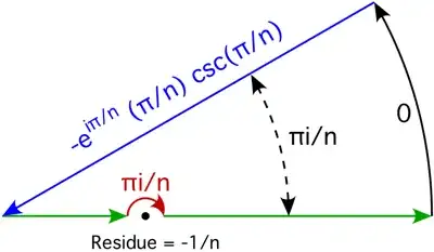

Cauchy Principal Value over $\mathbf{\mathbb{R}^+}$
Consider the contour
$\hspace{3cm}$enter image description here
Using this answer, we get $$ \int_0^\infty\frac{\mathrm{d}u}{1+u^n}=\frac\pi n\csc\left(\frac\pi n\right) $$ Thus, the integral on the blue line is $$ -e^{i\pi/n}\frac\pi n\csc\left(\frac\pi n\right)=-\frac\pi n\cot\left(\frac\pi n\right)-i\frac\pi n $$ The residue of $\frac1{1-u^n}$ at $u=1$ is $-\frac1n$. Therefore, the integral along the clockwise red semicircle is $$ i\frac\pi n $$ Since there are no singularities inside the contour, the total integral over the contour is $0$. Thus, the integral over the perforated green line must be $$ \mathrm{PV}\int_0^\infty\frac{\mathrm{d}u}{1-u^n}=\frac\pi n\cot\left(\frac\pi n\right) $$
Self-Contained Argument
Using the contour above and separating real and imaginary parts, we get that $$ \begin{align} \color{#00A000}{\mathrm{PV}\int_0^\infty\frac{\mathrm{d}u}{1-u^n}}+\color{#C00000}{i\frac\pi n} &=\color{#0000FF}{e^{i\pi/n}\int_0^\infty\frac{\mathrm{d}u}{1+u^n}}\\ &=\left(\cos\left(\frac\pi n\right)+i\sin\left(\frac\pi n\right)\right)\int_0^\infty\frac{\mathrm{d}u}{1+u^n} \end{align} $$ Looking at the imaginary part, we get $$ \int_0^\infty\frac{\mathrm{d}u}{1+u^n}=\frac\pi n\csc\left(\frac\pi n\right) $$ Then looking at the real part, we get $$ \mathrm{PV}\int_0^\infty\frac{\mathrm{d}u}{1-u^n}=\frac\pi n\cot\left(\frac\pi n\right) $$

In computing their table, they seem to have assumed that $f(n) = 0$. Indeed, their table is exactly equal to the one generated by
$$ g(n,x) = \text{PV} \int_0^x \frac{du}{1-u^n} - \frac{\pi}{n} \cot\left(\frac{\pi}{n}\right). $$
For example,
$$ \begin{align*} g(2.6,1.01) &\approx 1.75625, \\ g(2.6,1.02) &\approx 1.4927, \\ g(2.6,1.03) &\approx 1.33979, \\ g(2.6,1.04) &\approx 1.23215, \\ g(2.6,1.05) &\approx 1.14932. \end{align*} $$

    @nrs I found out how they calculated that table. – Antonio Vargas Jan 07 '13 at 00:59
