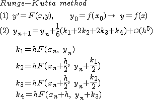

Now, for the fourth order method, it looks like this (and I'm lazy so I'll just attach an image instead of writing it all up):
Here, I think my intuition falls apart, as I cannot explain, for instance, why $k_2$ and $k_3$ are using $h/2$ and $k/2$ increment increases while $k_1$ and $k_4$ do not.
