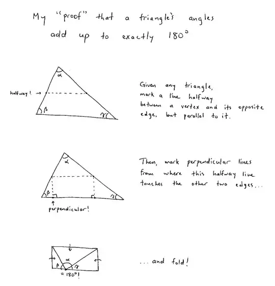

Back in grade school, I had a solution involving "folding the triangle" into a rectangle half the area, and seeing that all the angles met at a point:
triangle proof
However, now that I'm in university, I'm not convinced that this proof is the best one (although it's still my favourite non-rigorous demonstration). Is there a proof in, say, linear algebra, that the sum of the angles of a triangle is 180 degrees? Or any other Euclidean proofs that I'm not aware of?

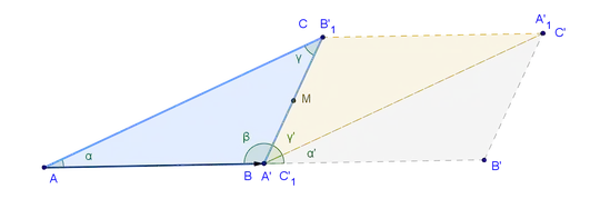

This demonstration adopts the point of view that Euclidean geometry is the study of the affine group in the plane (generated by reflections in $\mathbb{R}^2$). This group includes all translations and rotations. They preserve distances and angles. The role of this group, and in particular how parallel translation of vectors interacts with rotation, is prominent in the argument.
Translating triangle $ABC$ by vector $AB$ produces triangle $A'B'C'$ (which establishes that angle $ABB'$ is straight) and rotating $ABC$ around the midpoint $M$ of $BC$ produces triangle $A_1'B_1'C_1'$. Notice that $C=B_1'$ because $M$ is the midpoint of $BC$ and, also by construction, $C_1' = A' = B$.
Figure
Everything hinges on $A_1'$ coinciding with $C'$, as suggested in this figure. Although this is visually "obvious," there is something to be shown, because $A_1'$ is the result of rotating $ABC$ while $C'$ is the result of translating $ABC$. Among the many ways to make this demonstration, then, here is one that is geometric in spirit.
The image of vector $AB$ under the ($180^\circ$) rotation about $M$ is the vector $A_1'B_1'$. Because $180^\circ$ rotations negate vectors, $A_1'$ must be the translate of $B_1'$ by $AB$. Since (by construction) $C'$ is the translate of $C = B_1'$, $C'$ and $A_1'$ are coincident.
This shows that the straight angle $ABB'$ is decomposed into non-overlapping angles $\beta$, $\gamma'$, and $\alpha'$. Because translations and rotations preserve angles, the measure of angle $\alpha$ equals the measure of $\alpha'$ (its image under the translation) and the measure of angle $\gamma$ equals the measure of $\gamma'$ (its image under the rotation), whence the sum of the measures of $\alpha$, $\beta$, and $\gamma$ is the measure of a straight angle, $180^\circ$.
whuber
  • 8,750
    I see that rschwieb recently sketched the same approach. The figure may help in understanding it and the appeal to properties of the affine group should help make it rigorous, especially insofar as a crucial gap--proving the coincidence of $A_1'$ and $C'$--is concerned. – whuber Jan 03 '13 at 23:05
  • What have you used to sketch this figure? – Meysam Jan 04 '13 at 08:26
    @Meysam Geogebra is a free Java application designed for geometric illustrations. It's mature and works well. – whuber Jan 04 '13 at 13:53
    @whuber Thanks for recognizing our solutions have the same idea. I'm glad you offered more details: it's not my field, and I was just providing the easiest explanation I could think of. – rschwieb Jan 04 '13 at 15:11

There's nothing wrong with your "folding" proof. Fold = reflect. To formalize it, drop a perpendicular from the top vertex to the base. Call that point $P$. Then reflect the top vertex across the top horizontal side of the rectangle, and reflect each of the bottom vertices across the corresponding vertical side of the rectangle. Note that all 3 reflections coincide at $P$. End of proof.
An exercise: This result isn't true in hyperbolic or spherical geometry. Where does this proof use an axiom specific to Euclidean geometry?
Ted
  • 35,732
  • I think maybe the definition of reflection would use the parallel postulate, but I'm not sure. – Joe Z. Jan 03 '13 at 19:19
    Reflection itself is okay in other geometries, but the problem comes when you show that reflections coincide at $P$. Essentially, you need this result: Given a right triangle, if a perpendicular is drawn from the midpoint of the hypotenuse to one of the legs, then it hits the midpoint of the leg. To prove this, you need an argument with similar triangles or the like, which is only available in Euclidean geometry. – Ted Jan 03 '13 at 19:47
