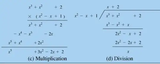

I cant figure out this math how are they doing this and coming up with the numbers they have. enter image description here
These operations seem pretty straight forward to me.
For the polynomial multiplication $(x^3 + x^2 + 2)(x^2 - x + 1)$ it splits the multiplication into 3 steps.
$(x^3 + x^2 + 2)(x^2 - x + 1) =$
$(x^3 + x^2 + 2)(x^2) + (x^3 + x^2 + 2)(-x) + (x^3 + x^2 + 2)(1)$
As for division, remember that the operation being performed is $\frac{x^3 + x^2 + 2}{x^2-x+1}$ and every step the numerator is being deduced by a factor of the denominator, which appear on the top.
I hope these hints explained how the operations are performed.
Mark R
  • 77
These are just the algorithms for integer multiplication and division taught to most elementary schoolkids, with powers of $x$ rather than powers of $10$. In fact that makes them easier, since you never have to carry when adding or borrow when subtracting.
