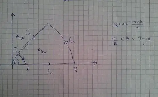

I need to calculate $\int_0^{\infty}{\frac{\ln x}{1+x^n}}$ $,n\geq2$ using complex analysis. I probably need to use the Residue Theorem.
I use the function $f(z)={\frac{\ln z}{1+z^n}}$ in the normal branch.
I've tried to use this contour.
Where $\theta$ is an angle so that only $z_{0}$ will be in the domain (I hope this is clear from the drawing)
I estimated $|\int_{\Gamma_{R}}|$ and $|\int_{\Gamma_{\epsilon}}|$ and showed that they must tend to $0$ when $\epsilon \rightarrow0$ and $R \rightarrow\infty$. (Is it true?)
However I'm having trouble calculating $\int_{\Gamma_{2}}$ . Does it have something to do with choosing the "right" $\theta$?
Any ideas?
Thanks!
UPDATE
After Christopher's comment I chose $\theta=\frac{2\pi}{n}$ which gives, after the paramatrization $\Gamma (t) = te^{\frac{2\pi i}{n}}$, $t\in(\epsilon,R)$:
$$\int_{\Gamma_{2}}{\frac{\ln z}{1+z^n}dz} = \int_{\epsilon}^{R}{\frac{\ln (te^\frac{2\pi i}{n})}{1+t^n}e^\frac{2\pi i}{n}dt} = e^\frac{2\pi i}{n}\int_{\epsilon}^{R}{\frac{\ln t}{1+t^n}dt} + ie^\frac{2\pi i}{n}\int_{\epsilon}^{R}{\frac{\frac{2\pi}{n}}{1+t^n}dt} =$$ $$ = e^\frac{2\pi i}{n}\int_{0}^{\infty}{\frac{\ln t}{1+t^n}dt} + ie^\frac{2\pi i}{n}\int_{0}^{\infty}{\frac{\frac{2\pi}{n}}{1+t^n}dt} $$
But I have no idea how to deal with the second integral.

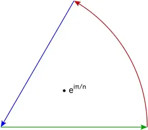

Using the contour in the question:
$\hspace{4cm}$enter image description here
contour integration gives $$ \begin{align} &2\pi i\,\mathrm{Res}\left(\frac{\log(z)}{1+z^n},z=e^{i\pi/n}\right)\\ &=\frac{2\pi^2e^{i\pi/n}}{n^2}\\ &=\color{#00A000}{\lim_{R\to\infty}\int_0^R\frac{\log(x)}{1+x^n}\,\mathrm{d}x} \color{#C00000}{+\int_0^{2\pi/n}\frac{\log(R)+ix}{1+R^ne^{inx}}iRe^{ix}\mathrm{d}x} \color{#0000FF}{-e^{i2\pi/n}\int_0^R\frac{\log(x)+i2\pi/n}{1+x^n}\,\mathrm{d}x}\\ &=\left(1-e^{i2\pi/n}\right)\int_0^\infty\frac{\log(x)}{1+x^n}\,\mathrm{d}x -e^{i2\pi/n}\int_0^\infty\frac{i2\pi/n}{1+x^n}\,\mathrm{d}x\tag{1} \end{align} $$ where the green integral is the outgoing line, the red integral is the circular arc, and the blue integral is the returning line. For $n>1$, the integral in red vanishes as $R\to\infty$.
Dividing $(1)$ by $-2ie^{i\pi/n}$, we get $$ i\frac{\pi^2}{n^2}=\sin(\pi/n)\int_0^\infty\frac{\log(x)}{1+x^n}\,\mathrm{d}x +e^{i\pi/n}\int_0^\infty\frac{\pi/n}{1+x^n}\,\mathrm{d}x\tag{2} $$ Taking the imaginary part of $(2)$, we get $$ \frac{\pi^2}{n^2}=\sin(\pi/n)\int_0^\infty\frac{\pi/n}{1+x^n}\,\mathrm{d}x\tag{3} $$ and taking the real part of $(2)$, we get $$ \sin(\pi/n)\int_0^\infty\frac{\log(x)}{1+x^n}\,\mathrm{d}x +\cos(\pi/n)\int_0^\infty\frac{\pi/n}{1+x^n}\,\mathrm{d}x=0\tag{4} $$ Combining $(3)$ and $(4)$ yields $$ \int_0^\infty\frac{\log(x)}{1+x^n}\,\mathrm{d}x=-\frac{\pi^2}{n^2}\csc(\pi/n)\cot(\pi/n)\tag{5} $$

  • Oh, the alternate method is great! +1 – Pedro Jan 03 '13 at 01:14
  • Awesome answer. –  Jan 04 '13 at 07:44
  • Could you give an explanation of how you evaluated the residue in the first line? It seems to be the hardest part of solving the question really, and I don't find it trivial to solve. – Briandmg May 28 '15 at 21:32
  • Scratch that. Just figured out you used L Hopital's rule. – Briandmg May 28 '15 at 21:42
  • @Briandmg: It's been a while, but I believe I used L'Hôpital. One can also use partial fractions to write $\frac1{1+z^n}$ as a sum of reciprocals of linear terms and look at the numerator of $\frac{A}{z-e^{i\pi/n}}$. – robjohn May 29 '15 at 00:05
  • Could you elaborate on why the red integral vanishes as $R\rightarrow\infty$? Also, in the blue integral, why don't you have $1+x^ne^{i2\pi}$? – John Keeper Jul 01 '19 at 01:29
  • @JohnKeeper: as $R\to\infty$, the red integral is $O!\left(\frac{\log(R)}{R^{n-1}}\right)\to0$. In the blue integral, $1+x^ne^{i2\pi}=1+x^n$. – robjohn Jul 01 '19 at 03:46

Let us define, for $r>0$, $$\Gamma_{r}=\{r e^{i\alpha}\ :\ 0\leq\alpha\leq\theta\}$$ The circular arcs of your contour are then $\Gamma_{\epsilon}$ and $\Gamma_{R}$.
We note that, for $z\in\Gamma_{\epsilon}$ $$\left|\frac{\ln z}{1+z^n}\right|\leq|\ln z|\leq 2\ln\epsilon$$ if $\epsilon$ is small enough. So $$\left|\int_{\Gamma_\epsilon} f(z)\right|\leq 2\theta\epsilon\ln\epsilon$$ which goes to $0$ with $\epsilon$. Also, for $R$ large enough, $$|\ln z|\leq 2\ln R$$ when $z\in \Gamma_R$. So $$\left|\frac{\ln z}{1+z^n}\right|\leq\frac{2\ln R}{R^n-1}$$ hence $$\left|\int_{\Gamma_R} f(z)\right|\leq\theta R\frac{2\ln R}{R^n-1}$$ which goes to $0$ when $R\to\infty$, if $n>1$. (So, yes, these two pieces go to zero)
Now take $\Gamma_1=\{r\ :\ \epsilon\leq r\leq R\}$ and $\Gamma_2=e^{i\theta}\Gamma_1$; define the contour $\Gamma$ by walking along $\Gamma_1$, then $\Gamma_R$, then backwards along $\Gamma_2$ and $\Gamma_\epsilon$.
The roots of $1+z^n=0$ are the $n$-th roots of $-1$, that is $$z_k=e^{i\frac{(2k+1)\pi}{n}}$$ so, if we take $\theta\in (\frac{\pi}{n},\frac{3\pi}{n})$, $\Gamma$ surrounds exactly one pole of $f$.
Now, following the hint of Christopher A. Wong, we set $\theta=\frac{2\pi}{n}$; therefore, if $z\in\Gamma_2$, we get $z^n=|z|^ne^{in\theta}=|z|^n$ and $\ln z=\ln|z| + i\frac{2\pi}{n}$.
So $$\int_{\Gamma_2}f(z)=\int_{\epsilon}^R\frac{\ln x + i\frac{2\pi}{n}}{1+x^n}e^{i\frac{2\pi}{n}}dx$$
We recall that $$\int_0^\infty\frac{1}{1+x^n}dx=\frac{\pi/n}{\sin(\pi/n)}$$ with the same method we used now (integrating on $\Gamma$!).
Call $J=\int_{0}^\infty \ln x/(1+x^n) dx$ and $L$ the residue of $f(z)=\ln z /(1+z^n)$ at $z=e^{i\frac{\pi}{n}}$, then $$2i\pi L=J-e^{i\frac{2\pi}{n}}\left(J+i\frac{2\pi}{n}\frac{\pi/n}{\sin(\pi/n)}\right)$$ that is $$J=\frac{2i\pi L+ie^{i\frac{2\pi}{n}}\frac{2\pi^2/n^2}{\sin(\pi/n)}}{1-e^{i\frac{2\pi}{n}}}$$
Now it is enough to perform the computations.
