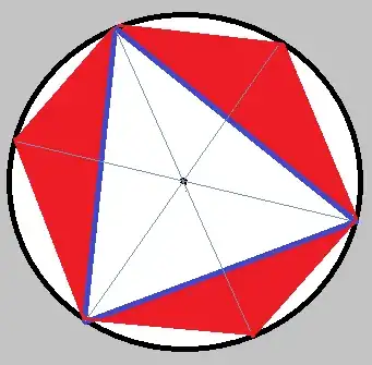

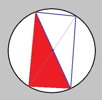

Take any triangle that contains the centre. Connect each vertex with the centre and continue the lines until they cross the circle. Now form the three 'outer' triangles, as shown in Figure 1.
These sets of 4 triangles are uniquely determined by any one of them, meaning that you can reconstruct all of them if you have any one. 1 of the 4 always contains the centre and 3 of them don't. In other words, the triangles that do not contain the centre are three times as much as those that contain it.
Therefore, the probability sought must be $\frac14$.

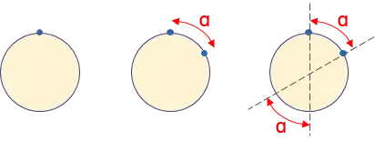

Take a circle with circumference $2$, and place the first point arbitrarily. Then the second point which will fall a distance $a$ away from that first point, where $a$ is somewhere between $0$ and $1$, with equal probability.
Then in order for the triangle to contain the centre of the circle, the third point must fall in a section of the circumference of length $a$ - which happens with probability $a/2$ - opposite the first two points, as illustrated:
Note that the third point has to be on the other side of the diameter from the first point than the second point - so at least half the circle is always excluded.
Thus the probability can be evaluated as:
$$\int_0^1 \frac a2 \ da = \left[ \frac{a^2}{4} \right]_0^1 = \frac 14$$
