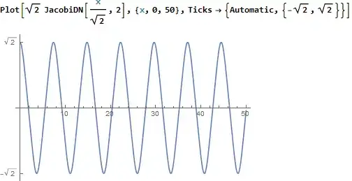

This equation is interesting in that the points $(z, z') = (\sqrt{2}, 0)$ and $(-\sqrt{2},0)$ are equilibria. So whenever $z$ hits $\pm\sqrt{2}$ the solution does not extend in a natural way. I guess that any physically meaningful solution will immediately escape this equilibria. One such solution is
$$ z(x) = \sqrt{2} \operatorname{dn} \left( \frac{x}{\sqrt{2}} \, \middle| \, 2\right), $$
which satisfies $z(0) = \sqrt{2}$ and $z'(0) = 0$. Here, $\operatorname{dn}(\cdot \mid m)$ is the Jacobi delta amplitude and we are adopting the convention that $m = k^2$ is the parameter and $k$ is the elliptic modulus. This at least provides a way of computing $z(x)$, but I am not sure if $\operatorname{dn}$ can be easily computed in a numerical way.
Finally, here are some computations using Mathematica.
Graph of z(x)
