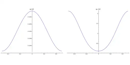

Let $x=q^{-2k}$ with $k\in\Bbb R_+$, let $k=K+d$ such that $K\in\Bbb N$ and $d\in(-\frac12,\frac12]$, then \begin{align} f(q^{-2k})&=\sum_{n\ge0} q^{n^2-2kn}\\ &=q^{-k^2}\sum_{n\ge0} q^{(n-k)^2}\\ &=q^{-k^2}\sum_{n\ge-K} q^{(n-d)^2}\\ &=q^{-k^2}\left(\sum_{n\in\Bbb Z} q^{(n-d)^2}-\sum_{n>K} q^{(n+d)^2}\right)\\ \end{align} Thus, $$ |f(q^{-2k})\cdot q^{k^2}|=_{k\to+\infty}l(d)+o(1) $$ where $$ l:d\mapsto\left|\sum_{n\in\Bbb Z} q^{(n-d)^2}\right| $$ and below is the graph of $l(d)$ with $q=\frac12$ and $-\frac12$.
