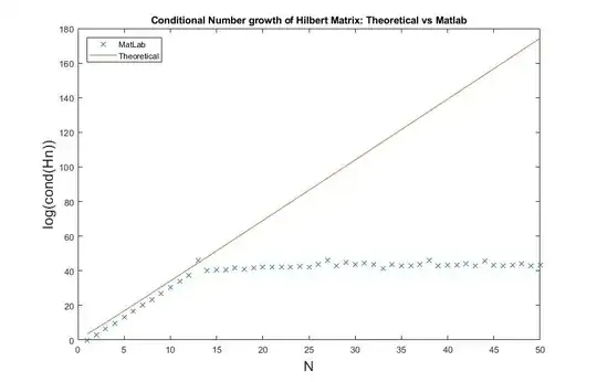

I need to investigate how the condition number of the Hilbert matrix grows with the size $N$. The Matlab command is cond(hilb(N),2):
  1. Compute the condition number of the Hilbert matrices $H_N \in {\Bbb R}^{N \times N}$, for all $N \in \{ 1, 2, \dots, 50 \}$
  2. Using Matlab to calculate the log of condition number of $H_N$ versus $N$. (The blue 'x')
  3. Compare this with the anticipated theoretical growth (The red line) of $$O\left(\frac{(1+\sqrt{2})^{4N}}{\sqrt{N}}\right) $$
I got a plot like this:
When $N = 13$, the Condition Number reaches the maximum. The Condition Number does not continue to grow when $N>13$. Why does the Condition Number stop growing after $N=13$?

  • Well, the log is in the range of $40$, I.e. the number is in the range of $10^40$ (adsinformation that $\log$ uses base $10$). What is the maximum number that can be represented by floating points? I am not sure that this is the reason, but it could be one factor. Wiki says "the maximum representable IEEE 754 32-bit base-2 floating-point value is (2 − 2−23) × 2127 ≈ 3.402823 × 10^38". – PhoemueX Feb 03 '18 at 08:24
  • $e^{40} \approx 2^{57.71}$, as @PhoemueX says it could be numerical issues that occur for large numbers. Exercise does not happen to be part of a course on numerical methods or technical calculations? – mathreadler Feb 03 '18 at 08:25
  • That is still smaller than realmax = 1.7977e+308. Could it be the accumulation of round-off error? I need to reason this phenomena – Di Wang Feb 03 '18 at 08:29
    $(f/x)^{-1}\cdot \Delta f/\Delta x$, or maximum singular value divided by minimum singular value, or $||A^{-1}||\cdot ||A||$ you could try these alternatives for condition number? (Took from https://en.m.wikipedia.org/wiki/Condition_number) – Emil Feb 03 '18 at 09:29
  • http://m.wolframalpha.com/input/?i=14x14+Hilbert+matrix – Emil Feb 03 '18 at 09:39
  • You could also debug in Matlab? Isn't the source code for cond included in the application? – Emil Feb 03 '18 at 09:53
    The IEEE machine epsilon is eps=$2^{-52}$. Calculations in the range above $2^{50}$ has too large round-off errors, which is clearly observed in this MATLAB example. – A.Γ. Feb 03 '18 at 10:01
  • @A.Γ. is right, that's what I meant with the 57.7 exponent. – mathreadler Feb 04 '18 at 09:13
In order to understand what exactly happens here, one has to take a close look at how the command cond is implemented in details, which I have not done (see the update at the end). However, one possible explanation for the phenomenon is the following: suppose you have to calculate the function $g(x)=x$, and the calculation is implemented as $g(x)=1/f(x)$ where $f(x)=1/x$. The function $g(x)$ has the linear growth (theoretically), but with floating point calculations for large $x$ (when $1/x$ becomes smaller than the MATLAB machine epsilon eps=$2^{-52}$) you will get round-off errors dominating in the denominator $$ g(x)\approx\frac{1}{\frac{1}{x}+{\rm eps}}\approx \frac{1}{{\rm eps}}\approx 2^{52}. $$ I guess that something similar happens in the command cond.
Update: After having a look at cond.m I confirm the phenomenon. MATLAB calculates the condition number for $p=2$ via SVD, that is, for Hilbert matrices it becomes $$ k(H_n)=\frac{\lambda_\max(H_n)}{\lambda_\min(H_n)}. $$ When $n\to\infty$ we have $\lambda_\max\to\pi$ (e.g. see this question) and $\lambda_\min\to 0$. Calculation with floating points for large $n$ looks as $$ k(H_n)\approx\frac{\pi}{\lambda_\min+{\rm eps}}\approx\frac{\pi}{\rm eps}\approx 2^{52}. $$

    Note that what you write is the definition on a condition number. According to your link to cond it says: The algorithm for cond (when $p = 2$) uses the singular value decomposition, svd. It means that the condition number for the Hilbert matrix is calculated as $$k(H)=\frac{\lambda_\max(H)}{\lambda_\min(H)}.$$ What happens here is exactly what I wrote in my answer. – A.Γ. Feb 04 '18 at 08:59
