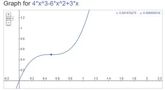

Suppose I define that, the function would pass at trivial point 0,0 and 1,1. Then it must pass point 0.5,0.5 with tangent 0
I then got this equation $y = 4x^3 - 6x^2 + 3x$
Which produce this curve

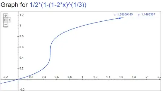

And so I got this inverse function $y = \frac{1}{2}(1 - \sqrt[3]{1-2x})$ which produce
And the curve only grow in one direction without decrease. What I made is actually a smooth step function. So the inverse of the function is also the function and always has root in every degree
