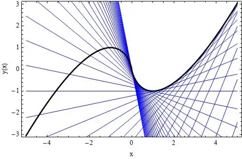

First note that your general solution is not entirely correct (you can check it by plugging it into your equation). The correct solution is given by $$ y_g=Cx-e^C $$ and depends on only one arbitrary constant.
Your singular solution is correct and given by $$ y_s=x\ln x-x. $$ How to show that actually there is always a point at which the general and singular solutions are tangent? Consider the condition that two functions are tangent at a point $x_0$: $$ y_g(x_0)=y_s(x_0),\quad y'_g(x_0)=y'_s(x_0).\tag{1} $$ (They should have the same $y$ coordinates and the same slope, and this is exactly what is written there.) From you solutions and using the second equality in $(1)$ you find that $$ C=\ln x_0. $$ Putting this value into the equality $y_g(x_0)=y_s(x_0)$ you will find an identity which proves that your singular solution is tangent to the general solutions.
Here is the picture:

First, yes, the solution is not unique. This is a highly nonlinear equation so it's behavior is quite different from the linear DEs we tend to focus upon. Now, the term "general" solution is also unfortunate since clearly the general solutions and singular solutions are distinct. The usual usage of the term "general" would force us to include both the general and the singular solutions into one big solution.
Turning to the other part of your post, pick any point on your singular solution, say $(x_1,y_1)$ then calculate, $$ dy/dx = d/dx (x\ln|x|-x) = \ln|x|+1-1 = \ln|x| $$ Hence the slope to the singular solution at $(x_1,y_1)$ is simply $\ln|x_1|$ hence the particular general solution $y = y_1+\ln|x_1|(x-x_1)$ is tangent to the singular solution at the point in question. This amounts to $c_1=\ln|x_1|$ and $c_2 = y_1-x_1\ln|x_1|$.
