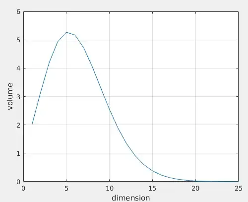

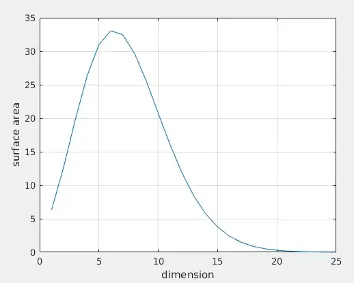

Is there any demonstrative / intuitive explanation for the behavior of the surface area and the volume of the unit ball as the dimension increases?
unit sphere surface area unit ball volume
I sort of get that it tends to zero, because all the coordinates become smaller and smaller (although I'm not quite satisfied with this "explanation"). But why the maximum? And why is the maximum not at the same dimension for the two quantities?

First, why there is a maximum: I think the easy way to get the meaning of it is if you kook at the recursion relationship between $V_n$ and $V_{n-2}$. $$V_n(R)=\frac{2\pi R^2}{n}V_{n-2}(R)$$ Ignoring $R$ since it's $1$ in your problem. you see that the volume increases or decreases by a factor of $2\pi/n$. You can see that if $n\ge7$ that fraction is less than 1, so the volume decreases. You therefore get $V_1<V_3<V_5$ and then $V_5>V_7>V_9>...$ And similarly for even dimensions. You would need to go into details of the gamma function to show the relationship between odd and even dimensions. It's just a little more calculation involved.
The second question is why they have maxima at different dimensionality. If you remember, the volume of the $n$-dimensional sphere becomes surface area of the $n+1$ dimensional sphere. If you look at this link, you get $$A_{n+1}(R)=2\pi RV_n(R)$$ Therefore if you have a maxima at $5$ in volume, you will get a maxima at $6$ in surface area.

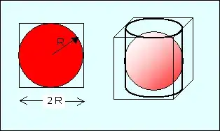

All the "strangeness" in the exposed results is just due to the fact that the volume of a $n-$Ball of radius $R$ should "normally" be compared to the volume of a $n-$Cube of side $2R$.
n_Ball_1

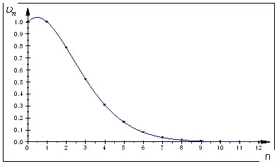

Then $$ \upsilon _{\,n} = {{V_{\,n} (R)} \over {\left( {2R} \right)^{\,n} }} = {{\pi ^{\,n/2} } \over {2^{\,n} \Gamma \left( {1 + n/2} \right)}}\, = {{\Gamma \left( {1/2} \right)^{\,n} } \over {2^{\,n} \Gamma \left( {1 + n/2} \right)}} $$
and this is a monotonic decreasing function for $n \in \mathbb N$,
which tastes "natural", because at increasing $n$, the volume of the $n$-ball will be less than that of the cylinder based on the $(n-1)-$ball, which in turn is always less than that of the unitary cube.
n_ball_2
Reversing the view, the ratio you have considered is that of the ball vs. the cube with one vertex at the origin:
in $3$D this corresponds to the unit cube covering one octant of the ball.
So you are multiplying the ratio $\upsilon(n)$ above (decreasing) by the number of octants, which is $2^n$ (increasing).
The maximum is just the result of the combination of the two opposite rates.
