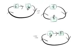

Approach #3: string diagrams
This proof involves the most category theory but it is also arguably the most beautiful. The intuitive idea is to think of taking the trace as "feeding a linear operator back into itself," so it looks like placing a linear operator in a circle in some sense, and then cyclicity follows from rotating the circle. This argument can be made fully rigorous; see this blog post and this blog post for the relevant pictures. After setting up appropriate notation and proving various lemmas, the proof of the cyclicity of the trace looks like this:
Among other things, approach #3 strongly suggests that the correct name for this property is cyclicity and not commutativity, because it clearly indicates that there is a generalization to cyclic symmetry for more than $2$ matrices: for example $\text{tr}(ABC) = \text{tr}(CAB)$ but is not in general equal to $\text{tr}(BAC)$.
