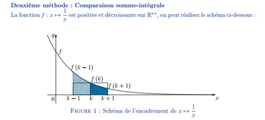

    You could try integrating $f(x)=\frac 1x$ between appropriate limits to get a tighter comparison - suggest drawing a diagram. – Mark Bennet Jan 02 '18 at 11:15

You can write that for $n \in \mathbb{N}^{*}$ $$ a_n=\sum_{k=n}^{2n}\frac{1}{k} $$ What I use to proof this ( without using an already known equivalence ) is to say that the function $\displaystyle x \mapsto \frac{1}{x}$ is decreasing ( and is positive and tends to $0$ ). Hence if you draw a decreasing function you can bound the function on $[n,n+1]$ by two rectangular area : a small and a big one. As shown below :
So it is written as $$ \int_{k}^{k+1}\frac{\text{d}t}{t} \leq \frac{1}{k} \leq \int_{k-1}^{k}\frac{\text{d}t}{t}$$
By summing with Chasles relation with $n \geq 2$ $$ \int_{n}^{2n+1}\frac{\text{d}t}{t} \leq a_n \leq \int_{n-1}^{2n}\frac{\text{d}t}{t}$$ then $$ \ln\left(\frac{2n+1}{n}\right) \leq a_n \leq \ln\left(\frac{2n}{n-1}\right)$$
Then the sequence $\displaystyle \left(a_n\right)_{n \in \mathbb{N}^{*}}$ converges and $\displaystyle a_n \underset{n \rightarrow +\infty}{\rightarrow}\ln\left(2\right)$.
