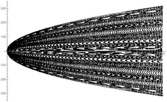

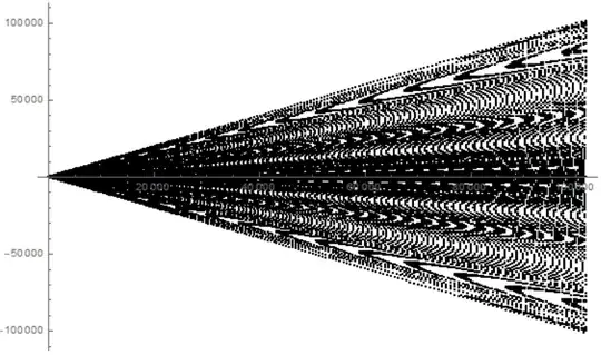

For example, here is the alternating ($\delta=-1$) "reverse pattern" with linear border $f(x)=x$, in number base $b=10$ for first digit case $d=1$: (Read $T(n,k)$ with described parameters by rows, and draw the terms as a scatter plot)
Or a similar example, but now $f(x)=\sqrt{x}$ (just the border changing example):
Question: How can we "explain" this pattern?
As of this update, my question boils down to: How can we describe these "arc" like, fractal like, patterns, in these plots of the "reverse/inverse" Pascal's pattern?

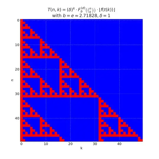

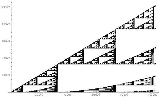

For example, if the $F$ was the "normal Pascal's pattern (not reverse/inverse Pascal's pattern given above)", now given by taking the binomial coefficients modulo some prime number, then this pattern represents the Sierpiński triangle (also called Sierpiński gasket):
In this particular instance, we have $\delta=1$ and modulo $b=2$ for the now $F_b(x):=x \pmod b$ transformation (Instead of the $F^{(d)}_b(x)$ transformation), and linear ("outer") border $f(x)=x$.
The answer to "explain this pattern" in this case, was given in a similar question regarding this pattern. - It was related to the Lucas' theorem.
But my question here is, considering this new $F$ ("inverse") pattern - how can we "explain" it? - Like the "normal pattern" is "explained" by the fact that it gives a well known fractal, the Sierpiński triangle, and this process of converting the Pascal's triangle to the Sierpiński triangle, relates to Lucas's theorem.

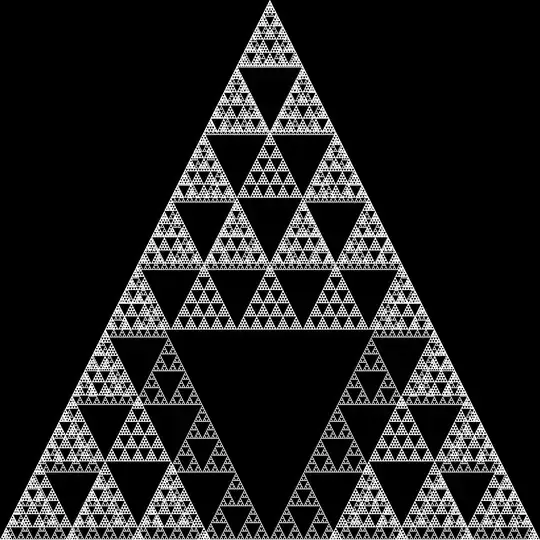

In general, numbers in pascals triangle produce sierpinski-triangl-like fractals. Some examples can be seen in this answer and are explained in this answer.
If we take the last digit of numbers (binomial coefficients) in the pascals triangle, and color the $\ne0$ digits white, we get the following image shown below; (First $1024$ rows)
Where this process is equivalent to taking $\binom{n}{k}\bmod m$ (where $m=10$ for this case) and coloring nonzero results. This is what was observed in the linked question/answers, for values of $m$ in general. (This is equivalent to taking last digit of binomial coefficients in some number base $m$)
Note that multiple patterns seem to be overlapping in the picture above. This is discussed in the linked answers. Only prime numbers $m$ produce clean patterns, and composite numbers like $10$ above are a combination of multiple prime patterns.

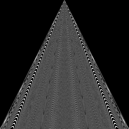

But what if we take the first digit, instead of the last one, in some number base?
For decimal case, we have the following image, for comparison to the above: ($b=10$)
Where we colored the pixel if the first digit of the binomial coefficient is $"=1"$. (Since $0$ can't be the first digit) Similar pattern holds for any other single digit, in any other number base.
Why does this pattern appear in the pascals triangle, in all number bases?
