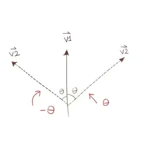

If I have two 3d vectors then I can use the dot product to find the angle between them. Since cosine inverse returns a value between $0^\circ$ and $180^\circ$, there are two vectors that could have had the same dot product value. If I want to rotate one vector to match the other I need to know whether to rotate $-\theta$ or $\theta$. How do I find out which direction to rotate? This image explains what I mean:

  • @LordSharktheUnknown true, their cross product will give me two different directions; one in and the other out. but how does that tell me when theta should be reversed. if i get their cross product all that gives me is another vector. – masonCherry Dec 29 '17 at 19:40
  • How do you know which rotation direction is positive and which is negative in the first place? If you look at the plane of rotation from different sides, the necessary rotation direction changes. You first have to define an orientation before your question can make sense. The cross product of the vectors can help you do that. – amd Dec 29 '17 at 20:34
  • @LordSharktheUnknown Right, I see your right. if I define a vector coming out of the screen as the axis I want to rotate about then I can use the dot product of the cross product of the two vectors and that axis. the dot product being less than or greater than 0 will represent the direction of rotation. Thanks – masonCherry Dec 29 '17 at 22:03
