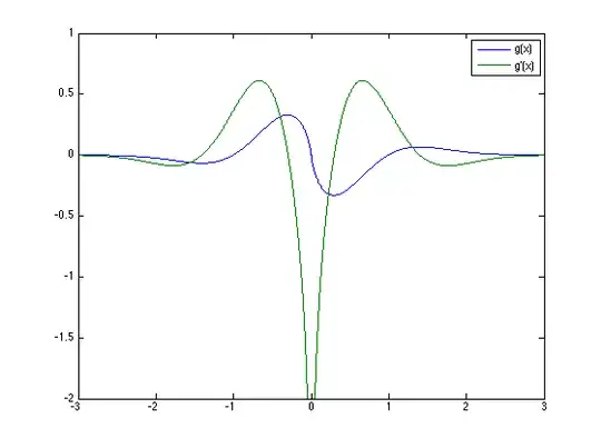

11
Oh, sure. I'm sure there are lots of examples, but because of the work I do, some modification of the entropy function comes to mind. Consider the following function: $$ f:\mathbb{R}^n\rightarrow\mathbb{R}, \quad f(x) \triangleq \begin{cases} x \log |x| & x \neq 0 \\ 0 & x = 0 \end{cases} $$ It is not difficult to verify that this function is continuous and has a derivative of $$f'(x) = \log|x| + 1$$ for nonzero $x$. So $f'(x)$ is unbounded at the origin; but $f(x)$ is unbounded as well, so we're not quite there. We can create the function we seek by multiplying $f$ by a well-chosen envelope that drives the function to $0$ at the extremes. For instance: $$ g:\mathbb{R}^n\rightarrow\mathbb{R}, \quad g(x) \triangleq e^{-x^2} f(x) = \begin{cases} x e^{-x^2} \log |x| & x \neq 0 \\ 0 & x = 0 \end{cases} $$ The first derivative for nonzero $x$ is $$ g'(x) = e^{-x^2} \cdot \left( ( 1 - 2 x^2 ) \log|x| + 1 \right) $$ which remains unbounded. Attached is a plot of $g$ and $g'$.enter image description here
EDITED to add: I notice that a number of other answers have chosen a bounded domain. From my perspective that is a bit incomplete. After all, we often consider such functions using the extended real number line, and in that context they are not bounded. There are certainly many functions that satisfy the original poster's conditions without resorting to a bounded domain.

    mcg: There are 3 other answers, and 2 of them have examples on unbounded domains. I do not understand the statement in your edit. (For example, I also mentioned the device of multiplying by $e^{-x^2}$ in my second example.) The question refers to functions of bounded variation, which usually refers to functions on a bounded interval (and having finite total variation). Although the question is somewhat vague on what it's looking for, I think our variety of complementary answers should cover the bases. I like your answer, by the way. – Jonas Meyer Dec 13 '12 at 02:32
  • Thanks Jonas. The (plural) answers I was referring to included the comment attached to the OP. I agree it is good to have a variety of answers here. But I do believe our job would not be done until at least one of us had offered a full-$\mathbb{R}^n$ solution, as we both have :P – Michael Grant Dec 13 '12 at 04:30
