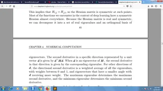

I am reading the following from the book Deep Learning, and I have the following questions.
  1. I don't quite understand second directional derivatives. The first directional derivative of a function $f:\mathbb{R}^m\to\mathbb{R}$ in the direction $u$ represents the slope of $f$ in the direction $u$. So what does the second directional derivative along the direction $u$ represent?
  2. In the above paragraph, I understood that $d^THd$, the second directional derivative of $f$ in the direction $d$ ($||d||_2=1$), is given by the corresponding eigenvalue when $d$ is an eigenvector of $H$, because if $d$ is an eigenvector of $H$ then $d^THd=d^T\lambda_d d=\lambda_d d^Td=\lambda_d$. However, I don't understand the statement "For other directions of $d$, the directional second derivative is a weighted average of all the eigenvalues, with weights between $0$ and $1$"::--Since $H$ is real symmetric, $H$ has $m$ independent orthogonal eigenvectors, which form a basis for $\mathbb{R}^m$. Thus, if $d$ is not an eigenvector, then $d=c_1x_1+\cdots +c_mx_m$ for some scalars $c_i$s and eigenvectors $x_i$s. Thus, $$d^THd=d^TH(c_1x_1+\cdots +c_mx_m)\\=d^T(c_1\lambda_1x_1+\cdots +c_m\lambda_mx_m)\\=c_1^2||x_1||^2\lambda_1 +\cdots +c_m^2||x_m||^2\lambda_m$$, which is ofcourse the weighted average of all the eigenvalues of $H$. But I don't understand why the weights lie between $0$ and $1$ as given. In fact, there is no reason to believe that the weights $c_i^2||x_i||^2$ to be in the range $(0,1)$.
  3. Also, I don't understand the statement "The maximum eigenvalue determines the maximum second derivative, and the minimum eigenvalue determines the minimum second derivative". Can you explain this?
