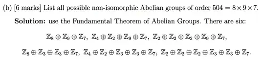

enter image description hereFirstly, for this we break the order in terms of its prime factors, and go from there ($8, 4\cdot2, 2\cdot2\cdot2$, $9, 3\cdot3$ and $7$). But why isn't $Z_{504}$ listed? Is that not a possible group G is isomorphic to?

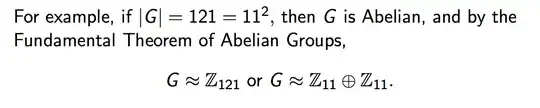

And then here, enter image description here
Why is $Z_{121}$ now listed? 121 is not prime so going off the previous examples I wouldn't list it as a group. Or am I missing some context here (because they don't specify non-isomorphic).

    I think it is because by Chinese remainder theorem, if $n_1, n_2, \dots, n_k \in \mathbb{N}$ are pairwise coprime, then $\mathbb{Z}{n_1} \oplus \mathbb{Z}{n_2} \oplus \dots \oplus \mathbb{Z}{n_k} \cong \mathbb{Z}{n_1 n_2 \dots n_k}$. – Alex Vong Dec 17 '17 at 18:38
  • But $11$ and $11$ are not pairwise coprime. – SS' Dec 17 '17 at 18:40
  • In fact, the first group listed, $\mathbb{Z}8\oplus\mathbb{Z}_9\oplus\mathbb{Z}_7$, is $\mathbb{Z}{504}$. Try to calculate the order of the element $(1,1,1)$ in this direct sum group. – Bob Jones Dec 17 '17 at 18:41
    @SS' But $\mathbb{Z_{121}}$ is not isomorphic to $\mathbb{Z_{11}} \oplus \mathbb{Z_{11}}$, so it is not a counter-example. – Alex Vong Dec 17 '17 at 18:43
It is listed. It is just written a little funny: there is a homomorphism
$$\mathbb Z \to \mathbb Z_8 \oplus \mathbb Z_9 \oplus\mathbb Z_7$$ given by $1 \mapsto (1 \mod 8, 1 \mod 9, 1 \mod 7)$ (basically send $1 \mapsto (1,1,1)$ and reduce accordingly.)
The chinese remainder theorem ensures that this is surjective, since all components are pairwise coprime.
It's kernel is precisely $504 \mathbb Z$, so the first isomorphism theorem tells that $\mathbb Z_{504} \cong \mathbb Z_8 \oplus \mathbb Z_9 \oplus\mathbb Z_7$.
The reason the same thing doesn't go through for $\mathbb Z_{121}$ and $\mathbb Z_{11} \oplus \mathbb Z_{11}$ is because the factors are not coprime. In particular, the same map clearly fails, since $1 \mapsto (1,1)$ is not surjective, and in fact its image is just $\mathbb Z_{11}$. In fact, we can see that $\mathbb Z_{121}$ is not isomorphic to $\mathbb Z_{11} \oplus \mathbb Z_{11}$, since the latter is not even cyclic.

The following sum of $\ 11\ $ summands $\ \mod 121\ $ is not zero:
$$ [1]_{121}\ +\ldots\ +\ [1]_{121}\,\ =\,\ [11]_{121}\,\ \ne\,\ [0]_{121} $$
however, the sum of $\ 11\ $ identical summands from $\ \mathbb Z_{11}\times\mathbb Z_{11}\ $ is zero:
$$ ([a]_{11}\ [b]_{11})\ +\ \ldots\ +\ ([a]_{11}\ [b]_{11})\,\ = \,\ ([0]_{11}\,\ [0]_{11}) $$
On the other hand, for two different primes $\ p\ne q\ $ you have group isomorphism:
$$ \mathbb Z_p \times \mathbb Z_q\,\ \longleftrightarrow \,\ \mathbb Z_{p\times q} $$
