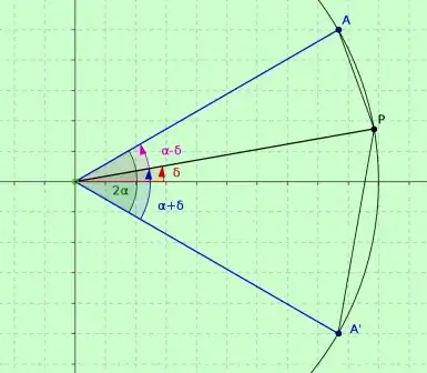

Take an angle $2\alpha$ and divide it into two parts $\alpha+\delta, \alpha-\delta$ as shown in this sketch.
n-agon_max
The area of the triangles $A'OP$ and $POA$ will be $$ \left\{ \matrix{ A_{\,POA} = \cos \left( {\left( {\alpha - \delta } \right)/2} \right)\sin \left( {\left( {\alpha - \delta } \right)/2} \right) = {1 \over 2}\sin \left( {\alpha - \delta } \right)\quad \left| {\;0 \le \alpha - \delta \le \pi } \right. \hfill \cr A_{\,A'OP} = \cos \left( {\left( {\alpha + \delta } \right)/2} \right)\sin \left( {\left( {\alpha + \delta } \right)/2} \right) = {1 \over 2}\sin \left( {\alpha + \delta } \right)\quad \left| {\;0 \le \alpha + \delta \le \pi } \right. \hfill \cr} \right. $$ and their sum $$ A_{\,tot} = A_{\,POA} + A_{\,A'OP} = {1 \over 2}\left( {\sin \left( {\alpha - \delta } \right) + \sin \left( {\alpha + \delta } \right)} \right) = \sin \alpha \cos \delta \quad \left| {\;\left\{ \matrix{ 0 \le \alpha \le \pi \hfill \cr - \alpha \le \delta \le \alpha \quad \left| {\;\alpha \le \pi /2} \right. \hfill \cr - \left( {\pi - \alpha } \right) \le \delta \le \pi - \alpha \quad \left| {\;\pi /2 < \alpha } \right. \hfill \cr} \right.} \right. $$ which is clearly maximum when $\delta =0$, i.e. when the angle $2\alpha$ is split symmetrically, whatever be its value $0 \le \alpha \le \pi$.
The bounds on $\delta$ are just preserving that the two triagles do not overlap.
Therefore starting with a triangle, you can demonstrate that any n-agon ($3 \le n$) inscribed in a circle has maximal area when it is regular.
