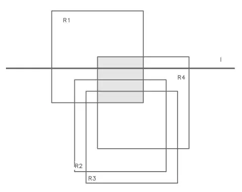

Bound 4. I claim that $n\le 3$. Indeed, assume to the contrary, there exists a family $\mathcal R$ of $4$ (congruent) rectangles representing Venn diagram. Define two orders $\le_x$ and $\le_y$ on $\mathcal R$. Namely, for rectangles $R,R’\in\mathcal R$ put $R\le_t R’$ if $t$-coordinate of the left side of the rectangle $R$ in not bigger that $t$-coordinate of the left side of the rectangle $R’$. Let $R_1\le_x R_2\le_x R_3\le_x R_4$ be the enumeration of the family $\mathcal R$.
Assume first that $R_1$ or $R_4$ is a minimal or a maximal element of $(\mathcal R,\le_y)$. Applying, if needed, to the plane transformations $x\mapsto -x$ and $y\mapsto -y$, without loss of generality we may suppose that $R_1$ is a minimal element of $(\mathcal R,\le_y)$. If $R_2\le_y R_4$ then $R_1\cap R_4\subset R_2$, contradicting the property of Venn diagram. If $R_3\le_y R_4$ then $R_1\cap R_4\subset R_3$, contradicting the property of Venn diagram. Thus $R_4\le_y R_2$ and $R_4\le_y R_3$. Now if $R_2\le_y R_3$ then $R_1\cap R_3\subset R_2$, contradicting the property of Venn diagram and if $R_3\le_y R_2$ then $R_2\cap R_4\subset R_3$, contradicting the property of Venn diagram.
Thus in the order $\le_y$ the elements $R_1$ and $R_4$ are placed between elements $R_2$ and $R_3$. But then $R_1\cap R_4\subset R_2\cup R_3$, contradicting the property of Venn diagram. Indeed, assume to contrary that there is an (interior) point $R_1\cap R_4\setminus (R_2\cup R_3)$. Let $\ell$ be a horizontal straight line going through the point $x$. It is easy to see that if $\ell$ intersects any of rectangles $R_2$ or $R_3$ then it contradicts the choice of $R_1$ or $R_4$ as a leftmost or a rightmost rectangle. Since $R_2$ and $R_3$ intersects, both $R_2$ and $R_3$ lie above $\ell$ or both $R_2$ and $R_3$ lie below $\ell$, a contradiction with that $R_2$ and $R_3$ are topmost and bottommost rectangles.

Suppose you have a Venn diagram with $n$ axis-aligned rectangles of the same width and height. By a scaling of the axes, we may assume the rectangles are all squares. Let's show that it's not possible to have a Venn diagram with $n$ axis-aligned squares for $n\ge4$, even if the squares are allowed to be of different sizes.
Suppose there were such a Venn diagram. By shrinking squares as necessary, we can assume the diagram is simple -- that is, each point of intersection of the perimeters of the squares is an intersection of just two squares. In that case, each pair of squares intersects exactly twice, for a total of $2{n\choose2}=n(n-1)$ vertices for the diagram, which implies a total of $2n(n-1)$ (topological) edges. From Euler's formula, $V-E+F=2$, we have
$$F=2+n(n-1)$$
and it's elementary to show that $2^n\gt2+n(n-1)$ for $n\ge4$.
