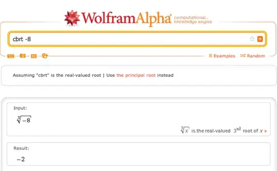

Although it's been two years since this question was asked, some folks might be interested to know that this behavior has been modified in WolframAlpha. If you ask for the cube root of a negative number, it returns the real valued, negative cube root. Here, I just asked for "cbrt -8", for example:

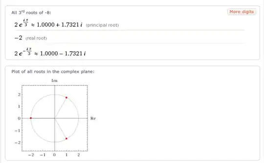

Note "the principal root" button. That allows you to toggle back to the original behavior. Near the bottom, we still see information on all the complex roots.

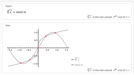

We can plot functions involving the cube root and solve equations involving the cube root and it consistently acts real valued. If you just type in an equation, it will solve it, plot both sides and highlight the intersections. Here's "cbrt(x)=sin(2x)"

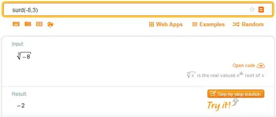

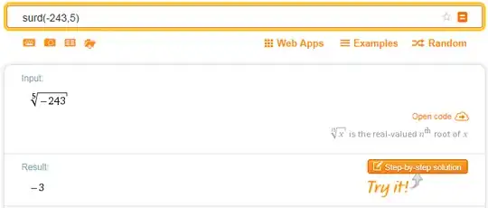

In the years since the question was asked and answered, Wolfram introduced the $\operatorname{Surd}(x,n)$ function (Mathematica 9 circa $2012$, then Alpha) to designate the real single-valued $n^{th}$ root of $x$.
For example $\sqrt[3]{-8}$ and $\sqrt[5]{-243}$ result directly in $-2$ and $-3$ respectively:
surd(-8,3)
surd(-243,5

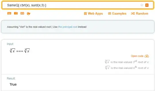

The $\operatorname{Cbrt}$ function discussed in Mark McClure's answer - which had changed behavior around the same time to return the real cube root by default - appears to be identical to $\operatorname{Surd}(\,\cdot\,,3)$:
cbrt-surd
