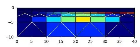

With a standard finite element method for the Laplacian, you could devise a mesh as follows, with triangles at the T-junctions and quadrilaterals anywhere else:
