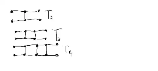

I will show that $\frac{m}{6}$ is not enough for 3-connected planar graphs. The following is inspired by fedja's comment (and also some nice discussion with Krystal Guo).
Consider the prism graph, which we will denote $P_n$. We say it has $2n$ vertices and $3n$ edges. Then in this case $\frac{m}{6} = \frac{n}{2}$. We will show that $\sigma(P_n) =n $. It is clear that $n$ paths is enough.
Consider the following graphs which we denote $T_n$:
$T_n$
and so on.. Note that $T_n$ has $3n - 1$ edges and $2n+2$ vertices.
It is not too hard to show that $\sigma(T_n) = n+1$ (and this is the best possible). One can show by induction, considering the left most edge between the upper and lower paths.
Let $p_1 , \ldots , p_k$ be a path cover of $P_n$. Now $P_n$ is two copies of $C_n$ with a matching, $M$, in between them. If every $e \in M$ is actually some $p_i$, then we have $k \geq n+2$.
So we may assume there is a $e = (u,v)$ such that the path, $p_i$, that contains $e$, contains at least one more edge, wolog say $(v,w)$.
$(i)$ The vertex $u$ is also contained in another edge of $p_i$ (other than $e$). Then $(V(P_n) , E(P_n) \setminus E(p_i))$ is $T_n$ minus at most two paths (actually, exactly two: the two paths start with precisely the two edges incident to $e$, respectively). In this case $k \geq n+1 - 2 + 1 = n$ (the last $+1$: don't forget to count $p_i$).
$(ii)$ The vertex $u$ is not contained in any other edge of $p_i$. Then let $p_j$ be another path that contains $u$. Then $(V(P_n) , E(P_n) \setminus (E(p_i)\cup E(p_j))$ is a $T_n$ minus at most 3 paths ($p_i$ is one path in $T_n$ and $p_j$ is at most two paths in $T_n$). It follows that $k \geq n + 1 - 3 +2= n$.
Thus we obtain $\sigma(P_n) = n$, as desired.
