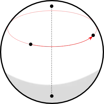

Orbits
Consider a sphere $S \subset \mathbb{R^3}$ and a group $G$ of (all) rotations along the OZ axis (north-south pole, as Earth).
$\hspace{70pt}$enter image description here
For every angle $\alpha \in [0, 2\pi)$ there is an element of the group $g_\alpha$ that would map a point $x$ of the sphere to the point $y = g_\alpha\cdot x$ such that the directed angle between would be $\alpha$. Observe that $S$ is a 3d object, where the group is almost like $[0,2\pi)$ - those are two different things, yet are joined by the "$\cdot$" operator, i.e. the group $G$ acts on sphere $S$.
What is an orbit then? See for yourself: $Orb(x) = \{ gx \mid g \in G\}$. That means the orbit of a point $x$ of the sphere $S$ is a set of all the points that a $G$ (i.e. rotations) can produce from it, in our case a circle, like the dotted one on the picture. Can you guess why it is called an orbit?
Stabilizers
Stabilizers are subgroups that won't disturb your points. In our sphere example, we have two kind of points: poles and non-poles. Does any rotation moves a pole? No, so $G_{\text{pole}} = G$. However, every other point would be disturbed by any non-zero rotation, hence the stabilizer of a non-pole point is a trivial group, $G_{\text{non-pole}} = \{1\}$.
In a more involved example, group of permutations of $\{A,B,C\}$, we can pick some element, let it be $B$, and still have a non-trivial stabilizer $G_{B} = \{(A)(B)(C), (AC)(B)\} \sim \mathbb{Z}_2$.
In conclusion: stabilizer of $x$ is the biggest subgroup that won't disturb your $x$.
I hope it explained something ;-)

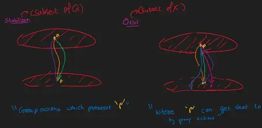

The group action ultimately is a map which takes a group element of a group G and element of a set X and maps back into elements of the set X (*). So, I have made two copies of the set and drawn the group actions as the threads connecting elements in each of the two sets.
Considering an element $ p \in X$ , those group elements which preserve $p$ through the group action are the stabilizers of $p$. This is what is shown in the left picture. Note that stabilizer is a subset of the group set.
On the right, we have the orbit of the same point $p \in X$. These are all the points which $p$ can be shot into other than itself in $X$ by the action of the group elements. Note that orbit is a subset of the set X.
Note that the orbit is a subset of $X$ while the stabilizer is a subset of $G$.
A few points to 'develop' interest
  1. All elements in the stabilizer correspond to one element in the orbit, 'x' itself!
  2. It turns out $X$ can be partitioned into disjoint orbits of it's elements! (Crazy..right?)
  3. Stabilizers turn out to be a subgroup!
  4. The orbit stabilizer theorem states that the product of the number of threads which map an element into itself (size of stabilizer set) and number of threads which push that same element into different elements (orbit) equals the order of the original group!
*:(...with some reasonable conditions on how the group acts on X)
