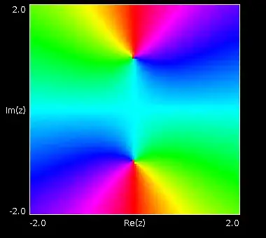

Unfortunately all the "cool" stuff connected with complex numbers is probably over the students' heads right now.
It's nice that you can find the roots of any polynomial and all, but all the "real action" is elsewhere.
Here is something that may be easy to explain. Because complex numbers are two-dimensional, a function with a complex domain and range has a geometric interpretation: it maps some two-dimensional space to another. So it can represent a geometric mapping, which morphs one space to another. That has not only obvious applications in computer-based visualization, but in problem solving: e.g. translating some problem with boundaries that are some oddly-shaped space into one over a rectangle.
Here is another. Because complex numbers are two dimensional, a complex-valued function can map each point in a two-dimensional space to a vector. In other words, complex functions can represent 2D fields. Properties of field, such as "fluxless" and "irrotational" can be connected to certain properties of the underlying functions which are nicely expressed using complex numbers.
And of course complex numbers have applications in signal processing, because signals exhibit frequency and phase, which give rise to two dimensions. The Fourier Transform uses complex functions, allowing a representation of a signal in the time domain to be taken into the frequency domain, with phase information. The magnitude of the complex number at each frequency tells us the amplitude of the signal at that frequency, and the angle of the complex number with respect to the real axis (the "argument") gives us the phase.

This is like Javier and Izkata's answers combined. Go to this site that plots complex function graphs and type in $$f(z)=z^2+1$$ then look at the top view. You will see the solutions are not along the horizontal center line. You could produce several of these graphs and ask students in groups to find out how they relate to the roots of the function.
