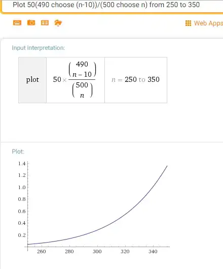

Here is an approximate approach, which should be pretty good when $m,k$ are reasonably large. First calculate the chance that the first bin is empty after you have removed $n$ balls. There are $mk$ balls total, so the number of ways to choose $n$ balls that leave bin $1$ empty is ${(m-1)k \choose n-k}$. The chance bin $1$ is empty is then $\frac {{(m-1)k \choose n-k}}{mk \choose n}$. If there are lots of bins and balls the impact of one bin being empty on the distribution of probabilities in the other bins is small. We are interested in cases where the chance bin $1$ is empty has rather low probability, so the chance of two bins being empty is even lower. The chance some bin is empty is then $\frac {m{(m-1)k \choose n-k}}{mk \choose n}$ The Alpha plot below shows this for $m=50,k=10$. It hits $0.5$ at about $320$ balls, where you will have removed $6.4$ of the $10$ balls in each bin on average.
