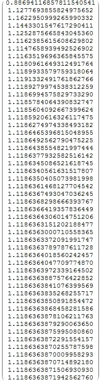

Now, the only thing that remains is to find the sums in the expressions above. i believe that they can be evaluated in closed form using the recurrence relations for the polynomials. I will attempt to finish this work asap. Meanwhile I only show the first fifty cumulative sums of the (integration-by-parts) series in question. We have:
whereas the quantity in question computed numeraically to forty digits of precision from the integral representations reads $1.118636387164187068349619257525640916795$.
Update: I have checked numerically that the infinite series in question do converge. Indeed we have : \begin{equation} \frac{(-1)^{n-1}}{n!2^{n-1}} \left( P_j^{(n-1)}(-1)\right)_{j=1}^3 \simeq \frac{1}{n^{1.79}} \cdot\left( 6.5, -8, 2.5\right) \end{equation} as $n\rightarrow \infty$. However, for the time being, I don't have any theoretical explanation for that behavior nor do I have a way to computing those series in close form.
