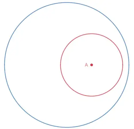

In order to define $P_L(u)$, one must find the area of the region $S_A(u)$, which is the intersection of a circle of radius $u$ surrounding $A$ and the dartboard $D$. If $\rho_A+u\le r$, then the circle is completely contained by the dartboard, and the area of $S_A(u)$ is simply $\pi u^2$.
overlapping

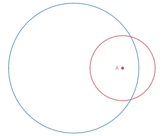

If, however, $\rho_A+u\gt r$, then the region is not a circle.
not overlapping
