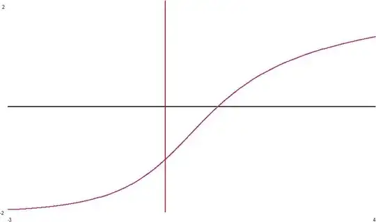

Here is the slog_e at the real axis from -3 to +4. slog at the real axis

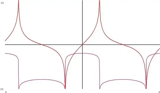

Here is the slog_e at the imaginary axis from $\Re(L)\pm 6i$ showing two periods and showing the singularities at $L,L_*+2n\pi i$. I limited the graph to +/-3.5 in magnitude. slog_e imaginary axis

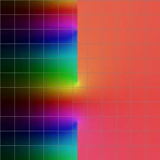

Here is the complex plane color graph for slog(z)+2, showing the $2\pi i$ periodicity to the left of the the $\Re(L)$ singulariy cutpoint line. The plot goes from $-5 < \Re(z) < +6$ and $-4 < \Im(z) <+7$. The slog_e is analytic on both the left and right side of these two cutpoint rays starting at $L, L_*$, with singularities as described above. As $\Re(z) \to -\infty$, the slog(z) goes to -2, which is why I plotted slog(z)+2 to clearly show the $2\pi i $ periodicity with the color scheme. slog complex plane color graph

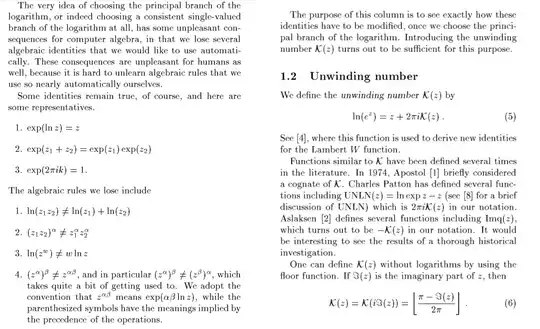

One should add, that the use of complex numbers in exponentiation follows the rules of a "clock-arithmetic" where the modulus is $2 \pi i$; such that the inverse operations is infinitely multivalued - and thus the pairs of numbers, which represent complex values might be seen as not expressive enough when it comes to exponentiation or even iterated exponentiation and even more to fractionally iterated exponentiation.
In a very interesting article mainly focused at the Lambert-W function R. Corless et al. investigated the possibility to add an "unwinding number" to the complex pair - this is one of the articles which I found (by chance, I've no consequent and/or organized literature base) where I saw the idea of adding information to the complex numbers - but I'm not sure about the outcome of this investigation (see a screenshot at the end).
If I recall right then the idea of the Riemann-plane (?) which has a 3-D-visualization is another ansatz for this "additive" information w.r. to complex exponentiation, but I'm too unfamiliar with this to say more than pointing to wikipedia etc.
For the exponentiation on complex numbers this becomes visible in the problem of division in the exponent, where "half of" an exponent is different if we assume that this exponent "has" already one rotation (around the fixpoint) "in it" or not... In my view it would be good to look at this problem deeper for improving the concept of fractional iteration of exponential functions to overcome this problem of "clock arithmetic" - or to state explicitely that this is not possible (and prove this or refer to this problem and proof on a more regular basis in the online-discussions). If such a thing ever comes out to be viable then surely only by adding one more information to the pair of real numbers to define a complex number especially when it come to exponents... (remark: in the language of statistics this problem is lack of scale-properties, that the exponent is only interval-scaled and not ratio-scaled)
From Corless& Jeffrey:
screenshot
  • Kneser's Tetration function shows some interesting winding as you go around the singularity at -2, adding $2n\pi i$ for each winding. – Sheldon L Nov 13 '17 at 16:41
