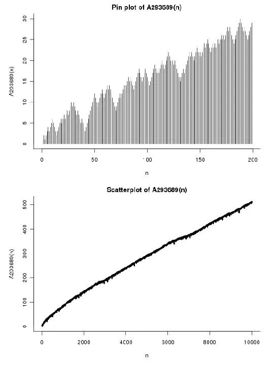

I have added this sequence to the On-Line Encylopedia of Integer Sequences (OEIS) as sequence A293689. Here's what the plot of the first 10000 terms looks like:
Plot for OEIS sequence A293689

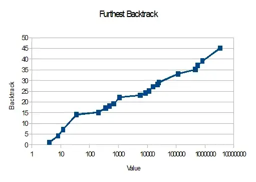

I ran this for a while, and observed the following patterns:
First, the prime ant seems not to backtrack. The maximum that it can backtrack seems to be about $0.35\ln(x)+0.3$.
This sequence is the first number from which the ant backtracks a certain amount of steps (From 8, the ant backtracks all the way to 4 before going forward again, etc).
Value   Backtrack
4       1
8       4
12      7
35      14
200     15
357     17
486     18
675     19
1078    22
5726    23
8575    24
11373   25
15652   27
22660   28
24654   29
117672  33
455580  35
554340  37
801256  39
3362574 45
Maximum Backtrack
This can be strengthened by observing that given $S(n)$ as the first $n$ terms of the values left behind, there exists a value $x$ such that if $x$ is appended to $S(n)$, an ant placed on the sequence will backtrack before the start. Let $X(n)$ be the minimum of all numbers that could cause this for the first $n$ terms of the values the prime ant leaves behind. Then $X(n)$ eventually grows very rapidly, and the prime ant's sequence is well-defined.
